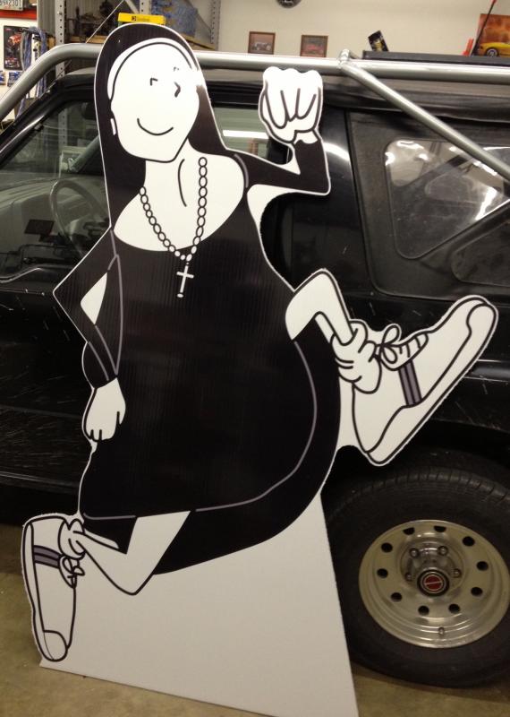

We just cut this one with a jig-saw with a fine blade in it last night. Make a stand for it now. It's a mascot for a race. Takes some sandpaper around it when you are done, but looks good in the end. Wasn't really too bad before sand paper. And yes, I know something is funky with her left arm (well, I guess it's her right). I just worked with what they gave me.
