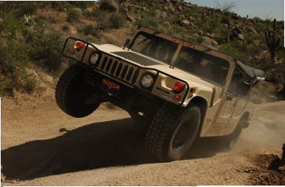

Replicator
I refer back to these images originally posted by VID . . . . !
It can be done . . . I 'm not that good . . . but there are plenty out there that are !

Flame
Um... sorry, but I don't get what these images have to do at all with what we were talking about?
The artist drew a vector of a vehicle. That's totally different than getting a template for a plastic piece on a motorcycle. You would never get the shape right.
But if you want to try to be sure for yourself, be my guest. I was just trying to save you time and money...
Replicator
Sorry flamey, once again I'd better read more closely today
as I am highly medicated due to an illness . . .
in fact i'd better just keep quiet for a while
before I explode all together . . . .:Oops: Sorry !
