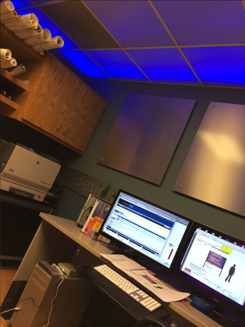

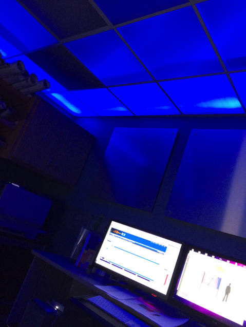

on a similiar note: I used clear coroplast scrap, along with some blue LED's, to jazz-up my own office not too long ago.
pretty awesome, especially when I lock myself-in & crank-up the jamz after-hours:

Side note-those blue LED's in the tiles are sicko. Nice work!
