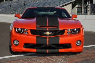

Customer called up yesterday asking if we could stripe his Camaro. I asked for exactly what he wanted to be sure first. He sent the rendering and its not your typical "Bumble Bee" stripes.
I've done vehicular vinyl before so I know I "can" do it but not sure I should do it because I don't know what is all involved. It can't be to much different than lettering a van but I assume it has it its own design and application intricacies that I'm not familiar with. Given that I have a few questions.
What vinyl to use? We mostly use Oracal 751 for everything except the fancy holographic, metallic, translucent, ect.. I would hazard to guess I want a re-positionable air release type of flat black for the best lay. Anything I'm missing?
Stripe design? I've painted stripes on many cars but thats a different type of beast all together. Would a cut graphic be better than laying a wide stripe on the car and cutting it out the same way I would mask for paint? If cut graphic is a good idea are there any templates available for the car or the stripes that can be used in flexi?

:-\ ... orcal 751 is fine, 951 is better ... cut, mask, cut apart, apply, trim edges. there isn't anything special about the stripe, so it just comes down to taking your time and make sure you measure.
prime signs
This install can be tricky, especially if you are not experienced with this type. The hood on the Camaro curves toward the front but it also has a radius from side to side. This leads to gathering as you work the vinyl. I would recommend a repositional air release vinyl instead of the 751. Don't cut the stripes on the car(Bad Idea) can come back to haunt you. Good luck with it if you take the job or not.

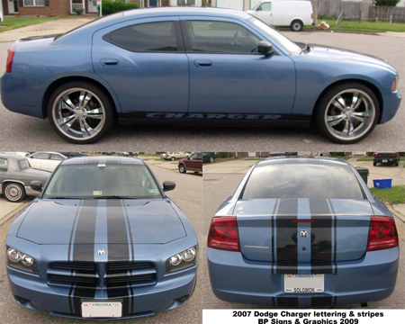

i just did a job like that over the weekend on a dodge sports car and the hood,trunk and roof no problems but going around the fin and down the from and back where you get the curves and grill took a little longer
took me about 3 hours from start to finish and i used 3m 180j w/ comply
sdwnymph
I did these stripes using Oracal 751. I measured the length of each piece and added a little more extra. When I did this car the main hard part was the grill due to way it was, but w/ doing the extra vinyl was able to "finangle it". Good luck.

Honestly, that job is much more difficult than it looks. We do them for mini cooper all the time, and its difficult. This one is harder. Let someone with experience do it.

I'm going to chime in with a helpful outlook, and pretend I didnt read the whole thread.
I would suggest using an air release vinyl, and laying down 3M blue fine line tape as a guide to hand cut the edges. This will give you flexibilty to install and measure out your lines. Cutting stripes on the car should be done with great care. Snap your blades repeatedly. Cut lightly. Practice on your own car first so you are aware of how much pressure is needed so as not to cut the paint. The front bumper is going to be tricky, even with the air release vinyl.
And dont do it cheap. Think about how much it would cost the guy to have it painted on and go from there. The fact that it is removable has some value too, like if the guy paints it on, he's stuck with it forever.

Orange Camaro?----may I suggest MATTE WHITE for the stripes.....kind of a reverse of the classic 69 Indy pace Car, and the 2011 Indy Pace Car.....
matte is the newest and hottest thing in vehicle graphics......matte black gets STUPID HOT in the summer----my car was matte black last summer, and my A/C was on 100% of the time......
Matte White might be a nice offering if you haven't done the stripe job yet.....
