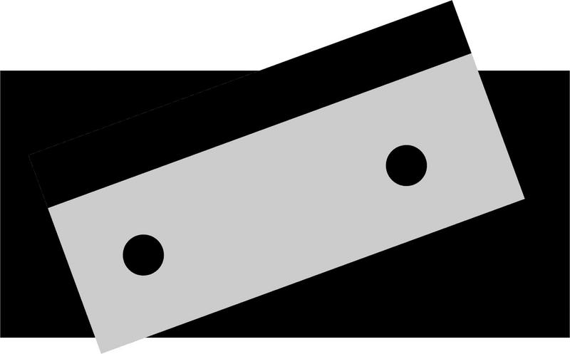

Piece of wood, two screws and a razor blade.

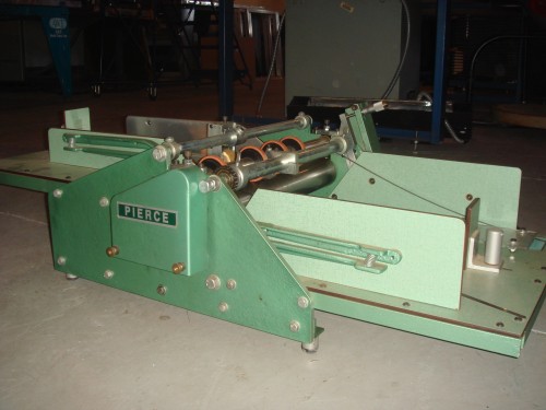

we have a slitter like this (not exact but similar) it has multiple blades and the depth is adjustable then we put our silk screened sheets through and it slits the backs on the entire sheet of decals and then we die cut them. unfortunately ours is so old not sure where you would even find one. but that is what you want for large runs. if you have more then 50 or maybe 100 you don't want to be slitting the backs by hand on each piece
Had one years ago, it's been forever since I had to do any slitting. Matter of fact, just sold my challenge paper cutter.
