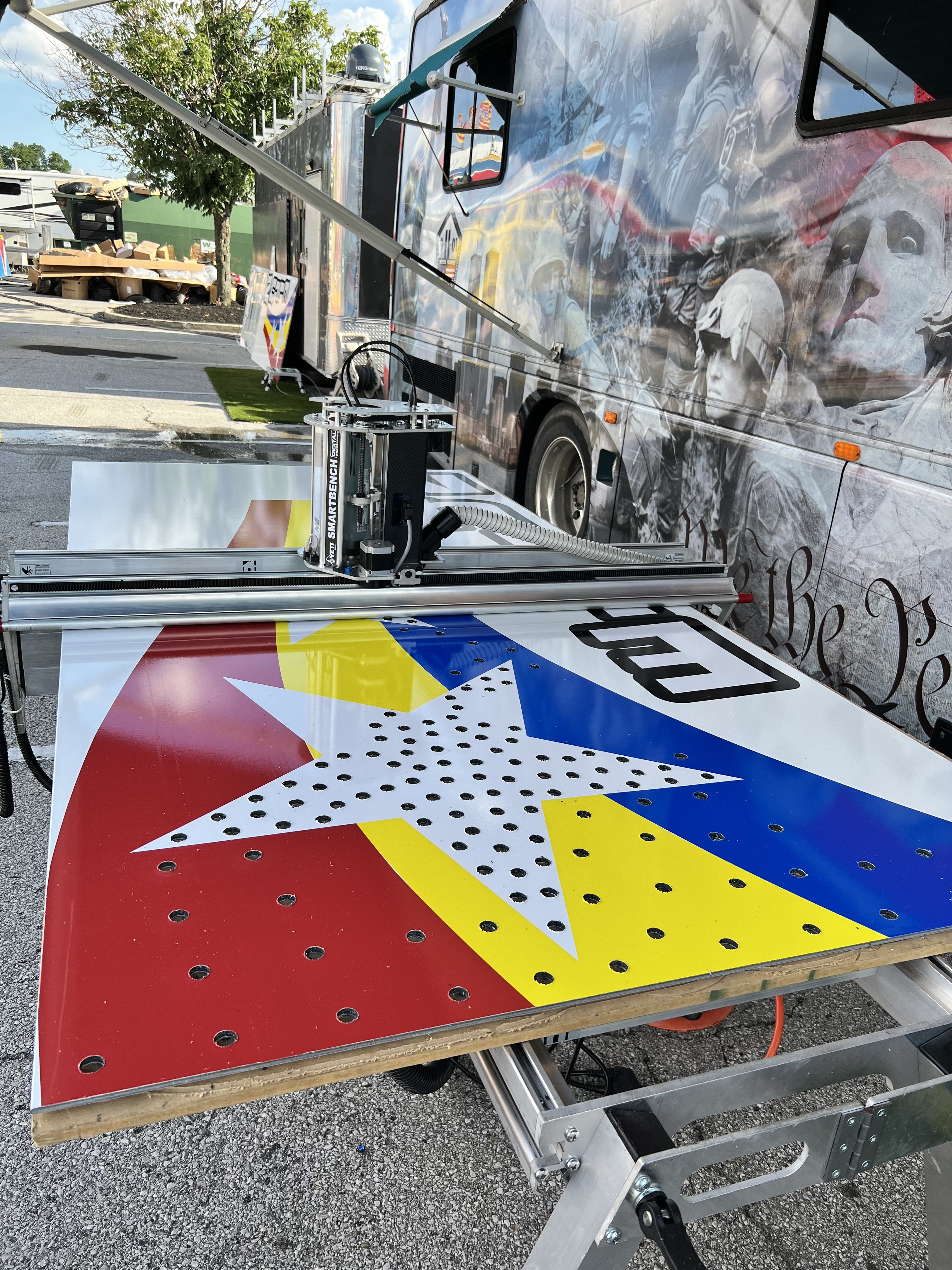

We have a Yeti Smartbench Precision Pro that we’ve used to cut MaxMetal (ACM) with vinyl applied first. Haven’t tried coroplast yet, but with the correct bit I’m sure it’s possible.
