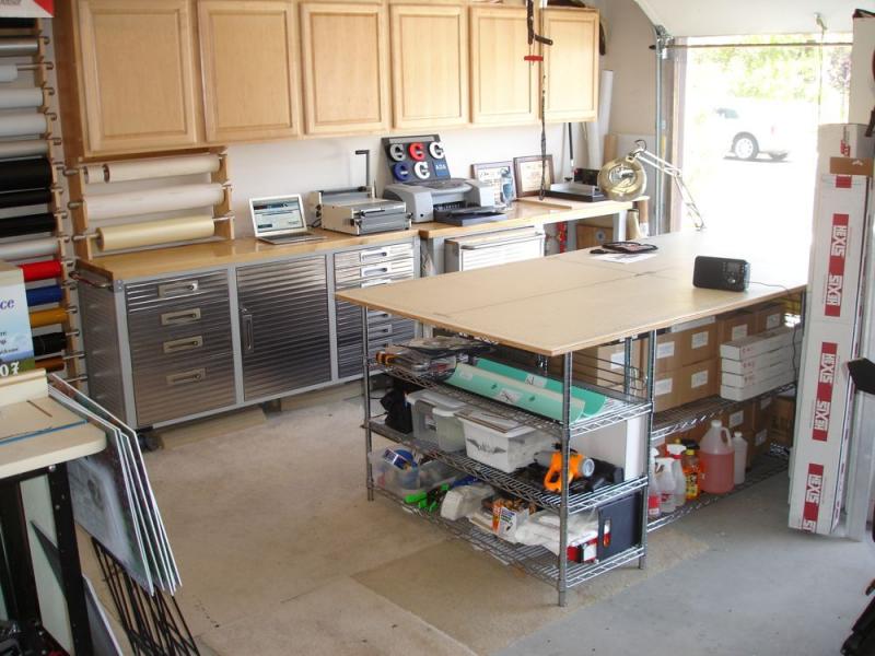

i have several chrome shelving units from costco, all i did was break down one of the units to create an "I" shaped base, lay a sheet of maple plywood down and top with a self-healing cutting mat.
voila.... great storage and cheap cheap!

Wow, All great help!!! Thank you everyone. GG your set up looks so nice and clean. Thanks again for the picture. That is a great idea and I may look into it. I spoke to a friend and he offered to help weld me up a steel table on casters. I may do that with a wood top and cutting mat.

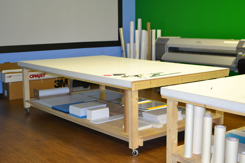

10sacer

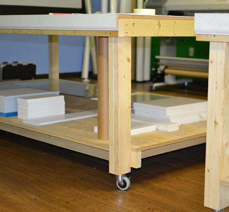

Work tables
Have two of these. Cost $280 for materials including the wheels for each.
Took about 4 hours each - but thats because I am anal and wanted everything square and level.
Just start with a 4'x8' box out of 2" x 4"s and work your way up.
Took an electric drill, circular saw, rip saw and a nail gun/hammer. Screwed lag bolts in with adapter on drill.

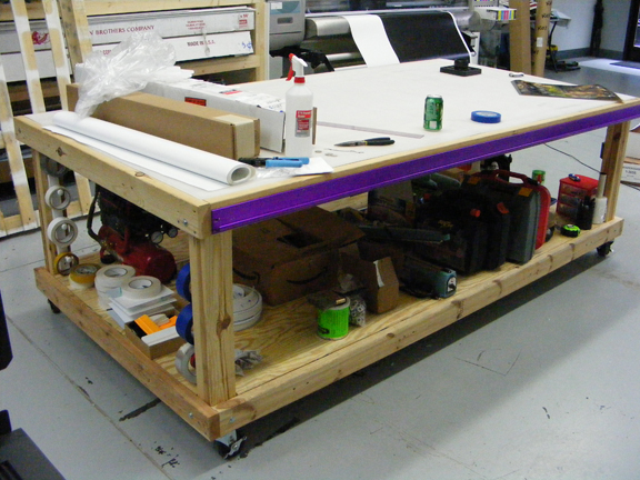

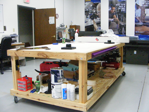

SnowFlake
A couple of pics of one of my 6' x 10' tables. I have 3mm sintra for the top, but I will probably be switching to a self-healing mat soon.

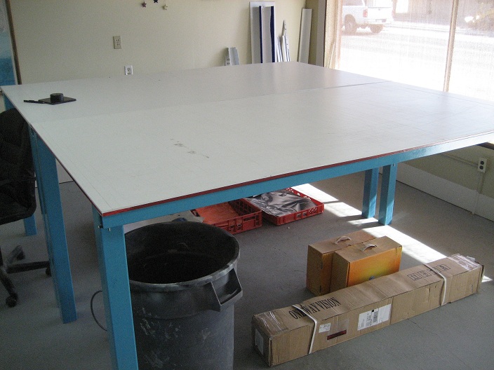

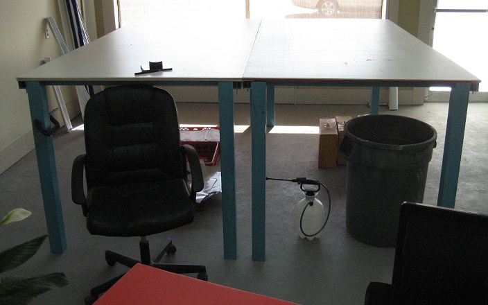

2B
we did our work tables out of metal (square tubing), 4x8 2 of them. this way they are light enough to make a 4x16 or a 8x8 which is what we use 90% of the time.
plus a custom built can be made to whatever height you want, suggest taller say bar height really saves the back from not having to be bent over for long periods of time
Here are the images, we are building shelves to attach to the underside for more storage area
