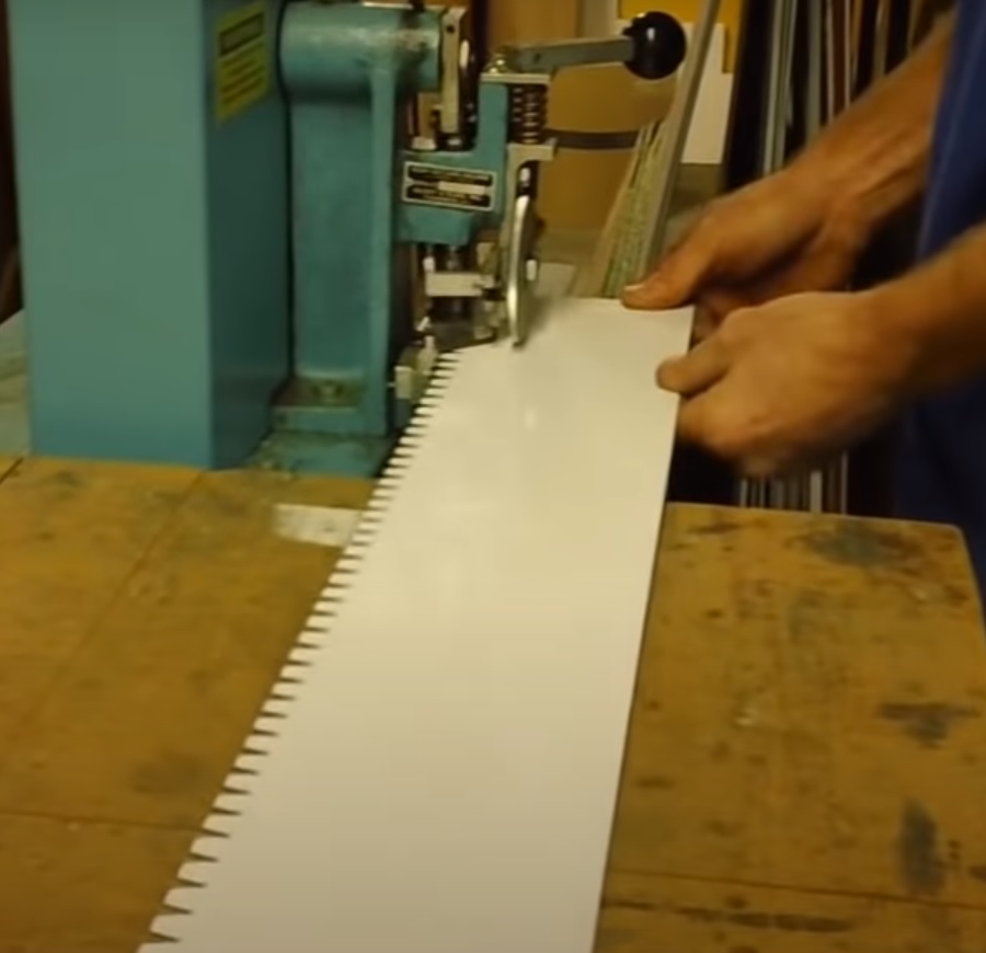

Hello! I am in the process to converting my shop to be able to make my own large format lighted signs instead of outsourcing them. I am pretty settled on what I need, but I just can't find one of the items on my list! What machines or press can I get to cut the tabs on the side my aluminum walls (for channel letters) ?

Here's a photo of what I mean. Might be easier with a reference !

Duck, you are about to get some advice...:eek:
Don't know why it's hard to find, same places that carry the other stuff you say you have lined up would have them.
Here's one https://www.amazon.com/Ving-Notching-Notcher-Machine-Channel/dp/B073QN6335
or for something better for a beginner, https://www.amazon.com/Duct-Notcher...5fdc4&pd_rd_wg=5DQXX&pd_rd_i=B01NAXQ44P&psc=1
I used a similar tool many times making channel letters when it wasn't as specialized a trade or as regulated
yeah my bad, as dumb as it is i live in a french provence, and didn't look up the term "notcher" . just kept searching for "tab cutter" haha Thanks for the info!
Any of the larger sign suppliers can get you in touch with a source. The sign supplier can be your biggest partner when it comes to this kind of stuff, some of the salesman have either worked in sign shops for years or have been selling to shops for years. Good luck.

The duct notcher that Bill shows works great. We've used one for many years. I suggest you start with one of those. The next step would be a one with a step pedal that will do about a foot of notches in one step. I can remember my first channel letter job. Not knowing anything about making them and with no internet we jumped in with both feet. The type style was Devine Bold, (no need to practice on a san serif, hell no) Well we did get the job done, but not before referring to channel letter fabrication as " letter wrestling "

you need a notcher. advice get a hand knotcher first. spend the 1600 dollars on marketing your new capabilities. i cant count how many shops i have seen one of those dinasours sitting in a corner, barely used. a few sets of letters a year is no big deal with a hand notcher. you may find like many others that wholesale letters are a pretty good idea.
