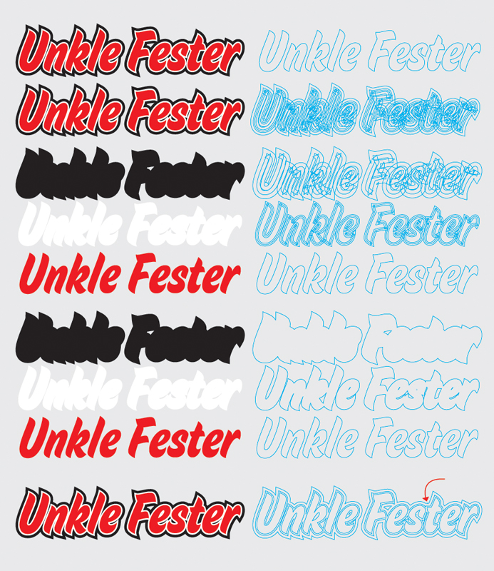

Here is what I did in a few minutes with 3 colors...you will notice an arrow where the thick stroke went a little wierd on me but that's a few seconds to fix.
On the "ungroup" being grayed out after you outline path....I'm not getting that at all...could that be a Mac/PC thing? I don't see why it would be but I don't have my PC running so I can't try it myself.

...holding down the shift key, I deselected the outer-most contour, and then deselected the 3 inside contours that were needed for "holes' in my final cut file. .
I had to hold ALT+SHIFT and then i was able to follow along. Thanks to your screenshots i saw the key i was missing... the pathfinder window with the "merge" icon... holy cow i cant believe how much time i wasted. select the intersecting layers and click "merge" lol man i feel dumb
