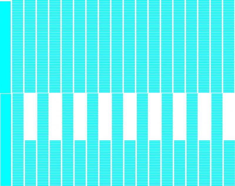

For the last few days we’ve been having cyan drop out. It prints fine for a few hours then it won’t print for two feet until we get
all kinds of dropout. It seems to get better with a pause/head clean but we have a non-functioning printer because it’s so bad.
I thought I figured it out by super purging the head (head raised so that I could see all the bubbles disappear (we do have this one cyan
head getting air). We’ve replaced the filter and all the lines coming down from the cleaning bulkhead. But I think I have two different
Cyan issues. One electronic, the other maybe clogging/air/heat dropout?

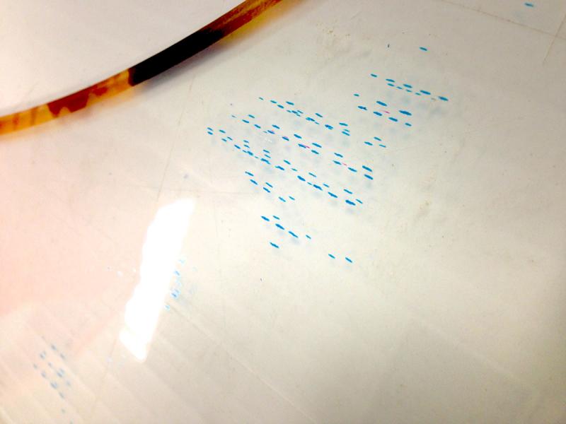

One thing I noticed the other day when I was babysitting the printer to get an order out was this ink dropping on the printer from the cyan
head (a few tiny hits from the magenta as well). I’ve seen versions of this when I hit “stop” and on the way back the printer will electronically
sprits the print on the way home. i've attached a photo of this issue.
also attached is an illustration of an odd test pattern immediately after at dropout. it's very intermittent. ...not natural or random like air or clogging.
to me it looks like data.
i'm going to do a proper data swap to see if i can get the magenta to drop out the same way from data.
i'd love to here some feedback on if anyone recognizes these to attachments and "telling" of a certain issue.
i'm assuming that most likely i need a new cyan head. i'll be pretty much sure of that is the case by the end of the day. IMG_0860.jpg Untitled-1.jpg

fixed! exotic theory too.
well, my last mention of needing a new head was incorrect. i did the data swap incorrectly by switching the cables at the head board. this of course did move magenta data to the cyan head. and they cyan head did still do the weird pattern. and the cyan data did print fine at the magenta head. but!!! it still left in place the cyan data cable connected to the cyan head at the base (head end). now we move the cyan head and we then get the same issue showing up on the rotated head. ...obviously something's up. we figured we isolated the issue to the cyan head and away from a data issue. so it would be impossible for a different cyan head to display the same behavior. except for the fact that i did the test with they old cyan data cable still attached at the head. oops. i even mentioned not to do this to the printer operator then did it myself. but still the air... hmmmmm?
so here's my theory. i've got inter-related data/ink starvation issues.
i believe that this on off jets all the way across the head... CAUSED BY A BAD DATA CABLE, can cause a venturi effect inside the head. you'd have one row of jets firing. and the adjacent row not firing. this would create a pressure see-saw inside the head and the weight of the ink being unbalanced. and the firing heads would then begin to pull ink out of the nonfiring rows at the top of the inlet. this would then draw in air into the non firing rows from the BOTTOM!!!!!!!!!!!!!!!!!!!!!!!!!!!!!!!!!!!!!!!!! (!!!!!!!!!!!!!!!!) ...!
we now have a new data cable (stolen from varnish) and printed an 8' x 4' block of solid CMYK bars and not a peep. we believe the ink "pooping" on the acrylic could still be the data cable issue, or maybe less likely static (because we've seen less intense versions of this with cmy and k occasionally)
