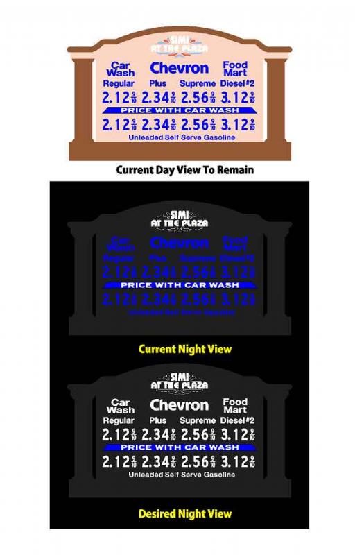

I have been looking for day night vinyl that is blue. I am wondering if I print on perforated window film if it would have the same effect? I need to show the push thru letters in the photo as blue during the day, and white at night, for obvious visibility issues.
Thank you for any help.

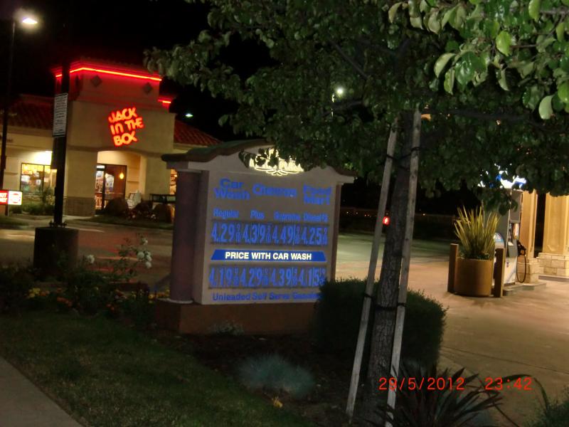

Wish I had other alternatives, but the blue looks murky against the dark background, as seen in the photo.
I think I will order a small amount of the perforated window film, print it Chevron Blue and hope for the best.

Haha, sorry for the confusion Mosh. Let me clarify for you...
Currently the letters have blue translucent vinyl mounted to the back of the clear acrylic push thru letters. Looks great during the day, but at night the illuminated blue becomes difficult to read against the non-illuminated background.

Correct...Day/Night vinyl comes in black or white. You can digitally print the blue on the white which will give you the effect you're looking for.
