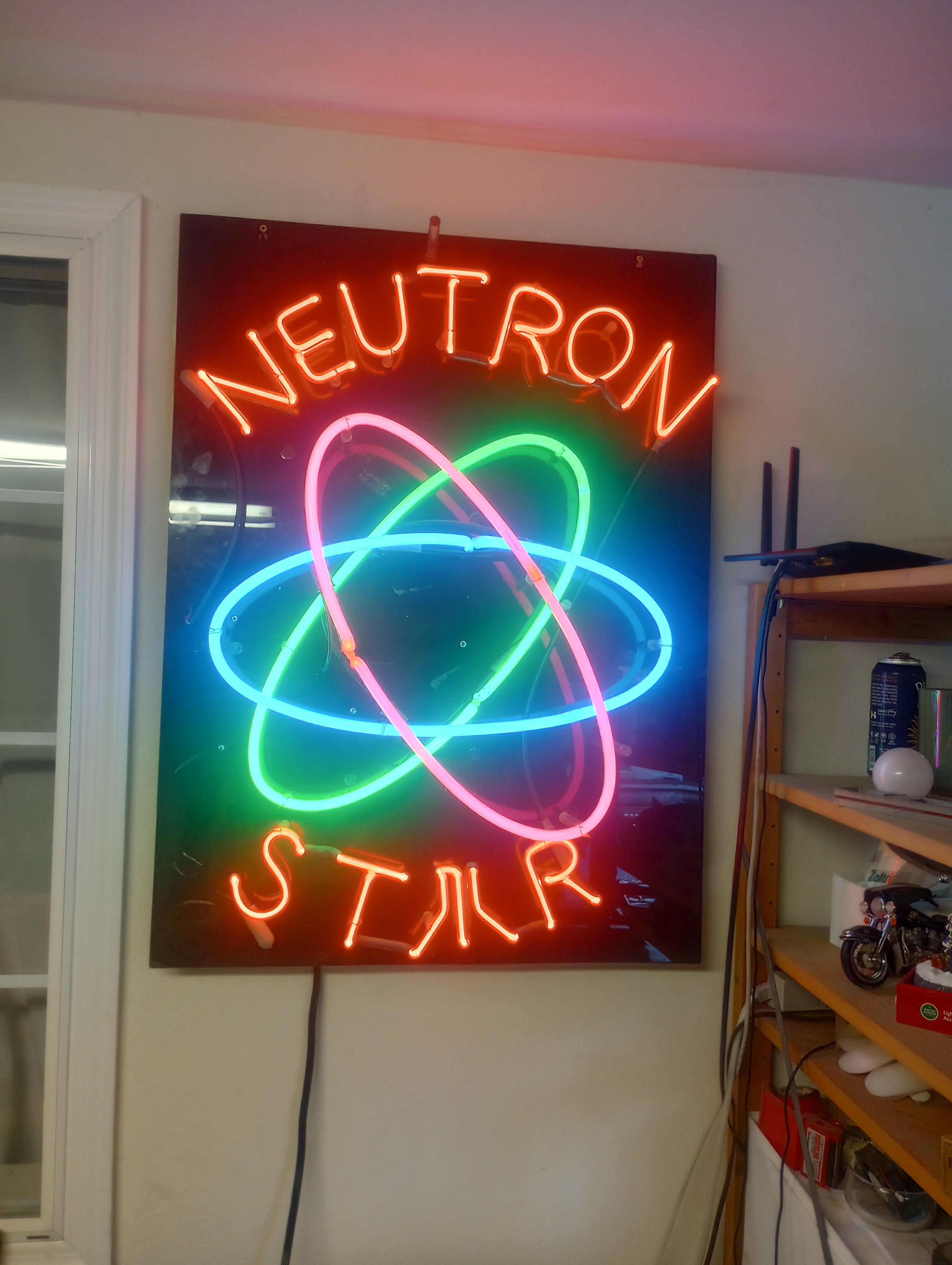

I have what i think is a basic question but i've searched and not been able to find an answer. i recently acquired a neon sign that was in storage for a long time. It came with 2 7.5kv 20ma AC output Franceformers. These transformers are loose and not mounted in any enclosure as well as fairly heavy. They were also not connected to the sign. The 4 wires coming from the neon tubes has bare ends on them whereas the leads on the Franceformers required some kind of connection. I took pictures to a local neon shop to see if I could pay to pay to get these done riight so I could safely take the sign to a pinball show. The sign is for a pinball game. The shop owner seemed to be confused when I asked about the difference between AC and DC to power the sign. He said he would just buy brand new DC variable output power supplies which are a lot lighter and would be easier to mount.
First three questions: I read that AC power will light the gas inside the tubes from both sides of the tube because of the alternating current, possibly prolonging the life of the tube. Is this true? Is it desirable to stay with AC?
Does AC provide cause a more uniform glow of the neon light being that it is being "lit" from both ends?
Fourth question: If it doesn't really matter with AC vs DC, if I get a couple lighter DC transformers should I stay with 7.5KV and that current? I measured the current when the lights where lit using a clamp on current meter and one measured about 15 mA and the other measured about 23 mA.
Final question: Presuming I stay with the heavy Francformers, I would like to put proper high voltage connectors on the bare ends in order to have a better connection as well as safer connection. All ends are now stripped wire. I was thinking of going to auto parts store and getting sparkplug boots and finding sparkplug connectors, but is there a better connector to use?

I presume you are asking about the bar sign tubes because I included a picture of the pinball sign all lit up nicely.

Update on retrofitting my Neutron Star sign and getting bar sign to work.
The 7.5kv DC power supply came in and powers both parts of the Neutron Star sign just fine. But only starts the bar sign, which has quite a longer length set of tubes as well as part of the tubes are smaller diameter. After it starts up it very quickly shuts down never to come back on. Probably because it is an electronic DC ballast of some sort whereas the dumb AC transformer will just keep sending 7.5KV AC to the tubes.
So I'm figuring it needs a higher voltage 10kv probably so I've ordered a 10kv 30ma and for grins I decided to also get a 5kv 30ma.
The 5kv arrived yesterday and it is nice and small, unfortunately it is a bare wire supply with bare wires for the 120v ac input. Jamming the bare wires into a receptacle I was pleasantly surprised that both parts of the Neutron Star sign sparked up and stayed lit when I tested each one. I'm running a longer test on it now to see if it will stay lit. One thing I noticed is that when powering the outside lettering I was getting some light from the internal ovals. The HV wires for the lettering run close to the ovals and moving them away from the lobes stopped the parasitic startup.

I've a question about current. According to what I've read, the current must be limited in order to not burn out the tubes. Will going from 20mA to 30mA cause the tubes to have a much lower lifespan? Also according to my understanding the AC transformers for neon lights have a shunt in them to prevent over current.
Since the 5kv-30mA power supplies light up the 2 parts of the Neutron Star sign just fine, I've mounted the two on the back of the sign and positioned them so that I can run the leads thru newly drilled holes and directly to the end of the neon tubes. Except for one which I need to extend the leads to get to the tube end.
This gets rid of the 2 7.5KV 20mA heavy transformers and makes the sign much easier to mount and more portable if I need to move it.
All the tubes seem to glow a brighter with the higher current rating of the new power supply and the tubes all seem to be uniformly bright.
Here is a new picture. I need to put a gto sleeve on the extension connection yet.
I'm including a link to some pictures of the actual Atari pinball Neutron Star
