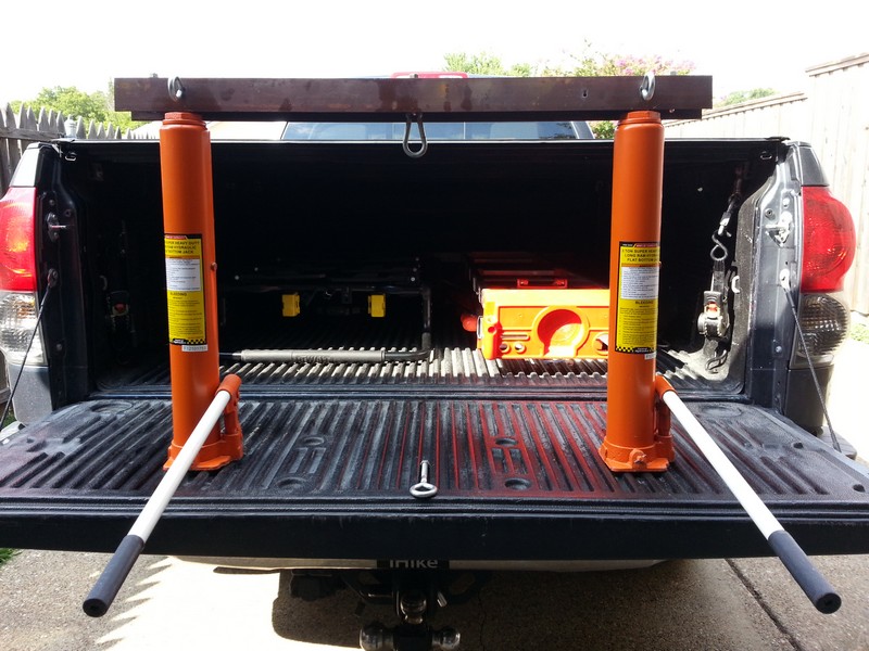

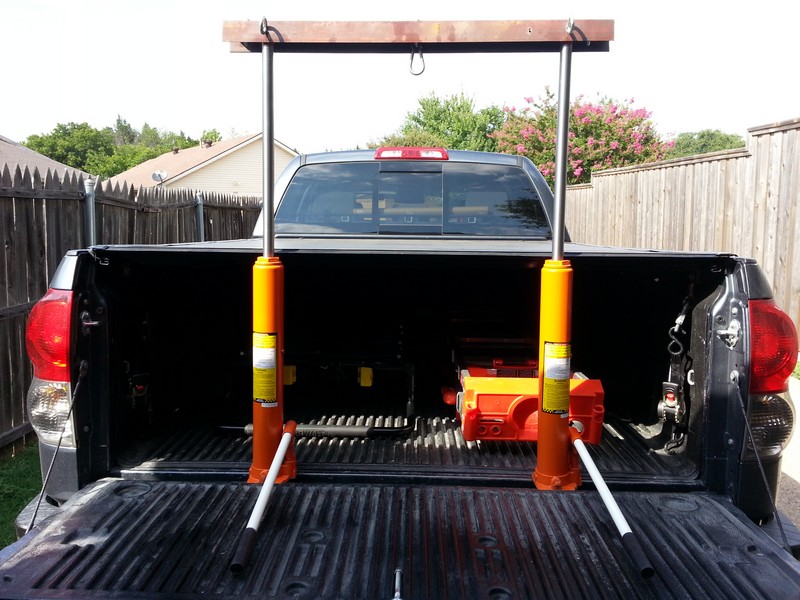

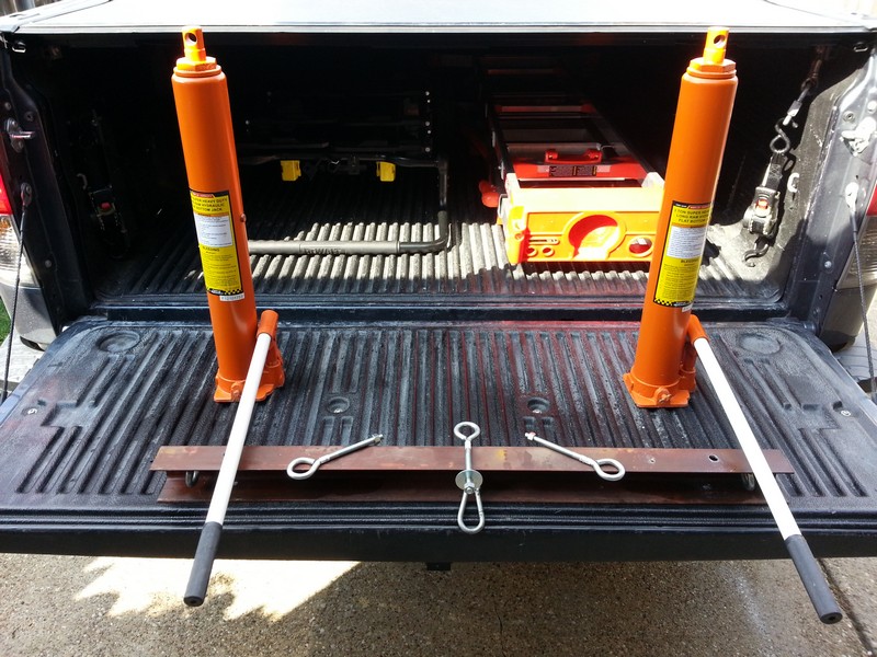

With the right setup, you can remove an existing post in about 5 minutes. The attached is what I use. Drill a hole in the post, run a bolt through it and the angle iron, and jack it out of the ground. Almost zero effort is required - the hardest part is carrying the removed post and base to your truck/trailer.
If the new post is going in the same spot, hopefully it's the right depth. If not, you have a pretty good start.

Billct2
When I worked at a municipal sign shop we had something like that for pulling u channels. But how does it work on a 3' deep concreted base?
Moze
I've done a few and it's a piece of cake. Just need to set the jacks on a 2x10 chunk of wood or similar or they'll sink into the ground.
