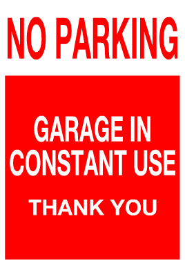

I am just starting out in this field of sign making and could do with some advice on designing a simple no parking sign for my friend, I am going to use landscape a4 size pvc sheet for the sign and want to use my vinyl cutter to make the wording, there will be two colours of wording, red and white, the white lettering will be overlaid on top of a red rectangular panel, and I need to cut these parts out separately, but when I do a preview in my signcut program its cutting everything out as one piece, any advice on where to start and how to do it please

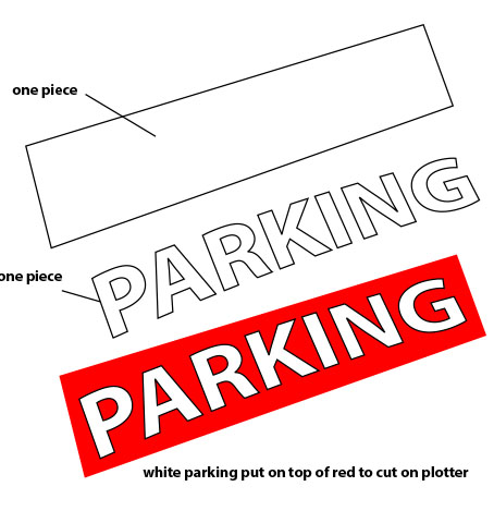

You have to have a vector (cut lines) for the red box and one for the copy which needs to be in front of red.
The plotter will cut the box lines and then the copy lines then peel out the copy letters leaving the red box with white copy.

Wait, I reread your post. Of course it will cut it out as one piece. You load your red vinyl in the plotter, cut out what you have in your cutting software. Unload red, pick out the word parking. When you attach your red to the substrate, what ever color that is will be the color for parking, so use a white substrate (painted metal, pvc, wood, plastic, foamboard).

No the rectangle and parking all get cut at once, then you peel out the word parking, apply transfer tape and put on white panel. When you remove tape the red rectangle will be there with white letters.

Yes! just saw your layout, your correct, good luck.

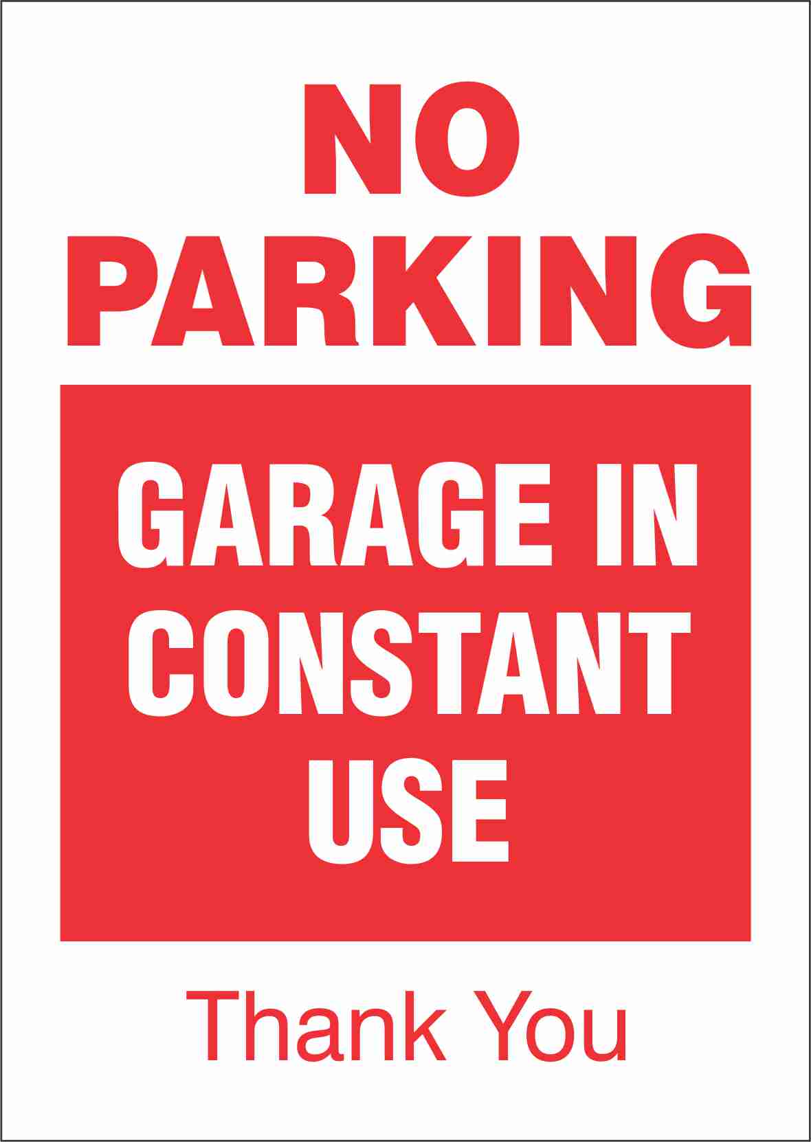

You got the technical part figured out, now try a tweak to the design. Since you're from England, the wording may be different, and over here like Gino said we generally threaten not thank.....but here's my take with your text. Try not to condense fonts to fit, and give text some "white space"
