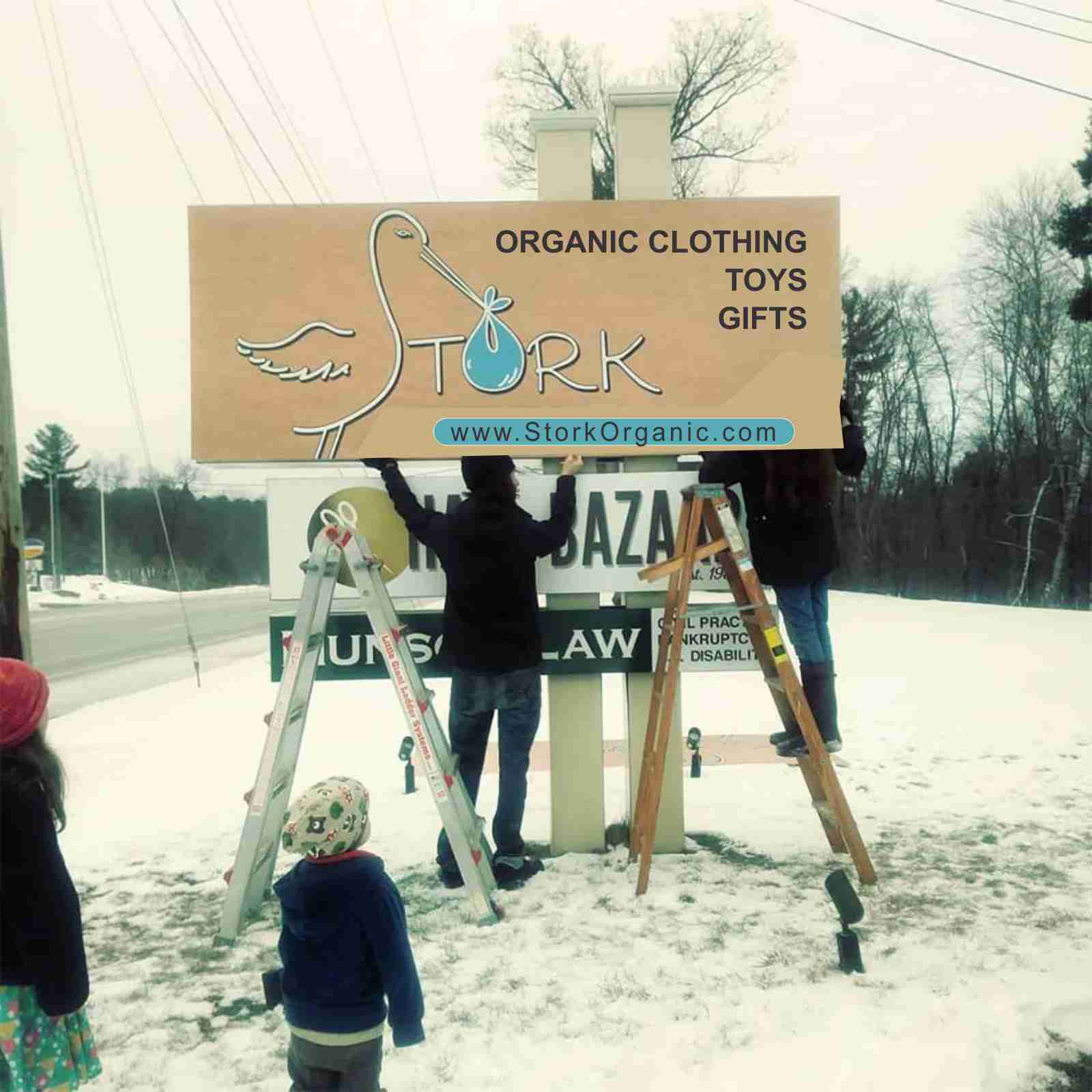

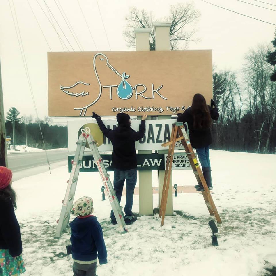

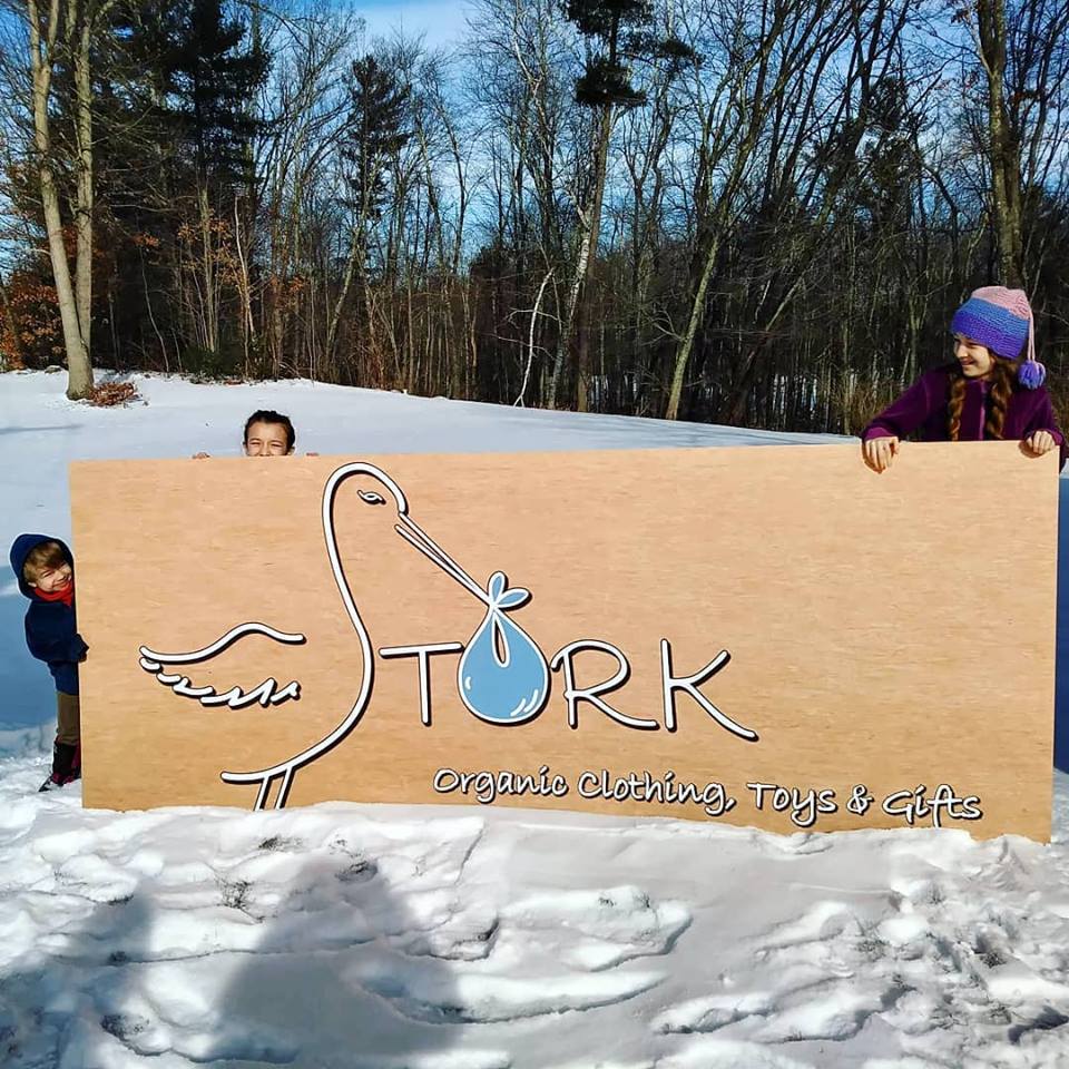

I have a client that ordered a large sign (46"H x 118"W - Double-Sided).
They were very specific with how they wanted their logo, even though we suggested adding larger lettering to fill up the space. This sign is on a busy highway and now that it's up, it's hard to see the "Stork" logo when you drive by, let alone the smaller "Organic Clothing..." underneath. Does anyone have any suggestions on what we can do, with minimal cost, to make this more visible? TIA!

The stork image needs to be revisited. As it sits, it takes up too much room and forces all the text into an awkward size & position. Use the stork on the side and don't have it work into the word "Stork"..looks like "Tork".
Font needs to go entirely and should be bolder and cleaner looking. I'd rethink using light colored text on a light colored background (with only the shadow in dark)... Effectively you're only seeing that back shadow and it's just impossible to read.
I don't think there is anyway around a complete redo of that sign.

Judging by the way you two are holding it, it's not very heavy. I'd take it down and go back to the drawing table.... AFTER you hash it out with the customer that it will cost $XX amount of dollars to correct their mistake.
Heftier lettering, diminish the stork and much more contrasting colors will certainly help.

Even if you are stuck with the logo as-is, the biggest readability problem you have is lack of contrast. White on parchment is never going to be readable, and the black outline doesn't really do much. It's the same problem I see when people use a printer for everything and letter vehicle windows (essentially black) with a red or blue logo, thinking that their white outline for cutting will give it contrast. It doesn't.
Make the background of the sign black with the white and light blue logo and see how much better it reads.
If you can talk them into altering the logo, make the bird smaller (primarily shorter), which will require changing the angle of the beak to keep the bundle (O) the right size. Then make the whole logo bigger so all the letters are bigger. You should be able to do that so that STORK goes full width of the sign, towards the top, while leaving the whole width of the bottom for the list of things they sell.

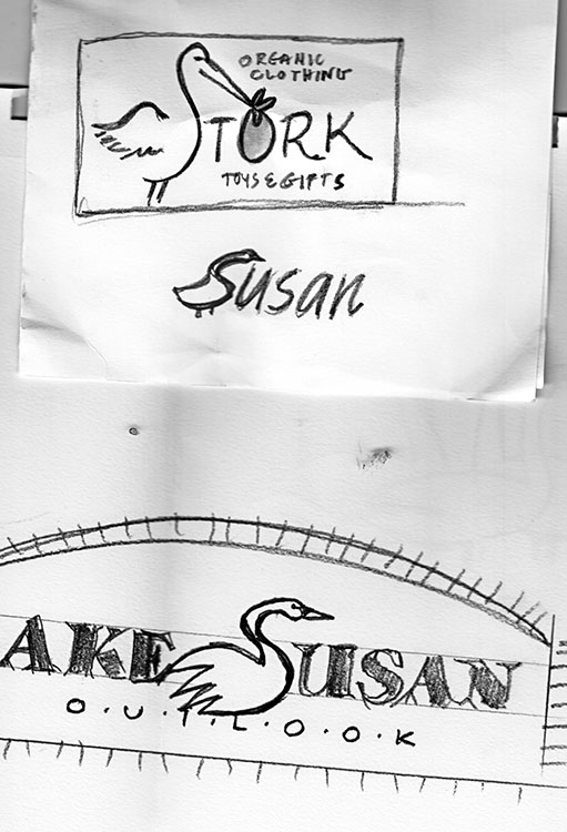

Don't be afraid to manipulate your customer's logo if it really doesn't work for a sign. (Ignore the kerning please)

I like the Stork logo, you just need to readjust it to fit better. I am sure they have their label on everything and try to use logo for recognition. White back with dark letters would work better. Made a rough for layout as others have suggested.
