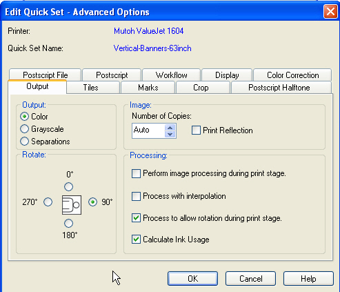

My Onyx RIP has an ink calculation function... you can enter $/ml and it is supposed to tell you how much $$ the job cost to print.
When ever I use it on my system the RIP crashes, so I have not turned it on. I am on 7.0, maybe it is fixed on 7.1?? Where's Scotty?>

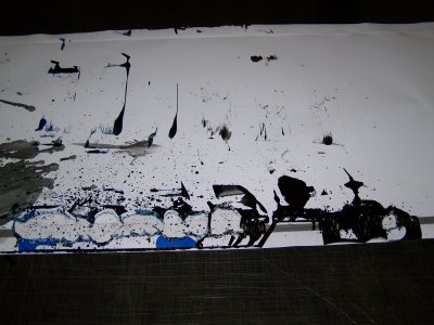

When you figure that out, please also do the math on a roll of media. This is what happens at 2:00 am this morning. No it's not art, it's a sheet getting stopped on a run. Ya know, the whole tape to the roll hitting the backside of the printer. After two hours cleaning, we're back in business. Our Mutoh is tough! Wish it had some kind of alarm bell or buzzer that would tell you when you're getting low on ink or paper.

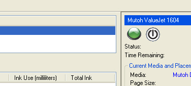

jiarby
It shows up in the job list where it is "Ready To Print". Waay off to the right are some columns for Ink Use.
