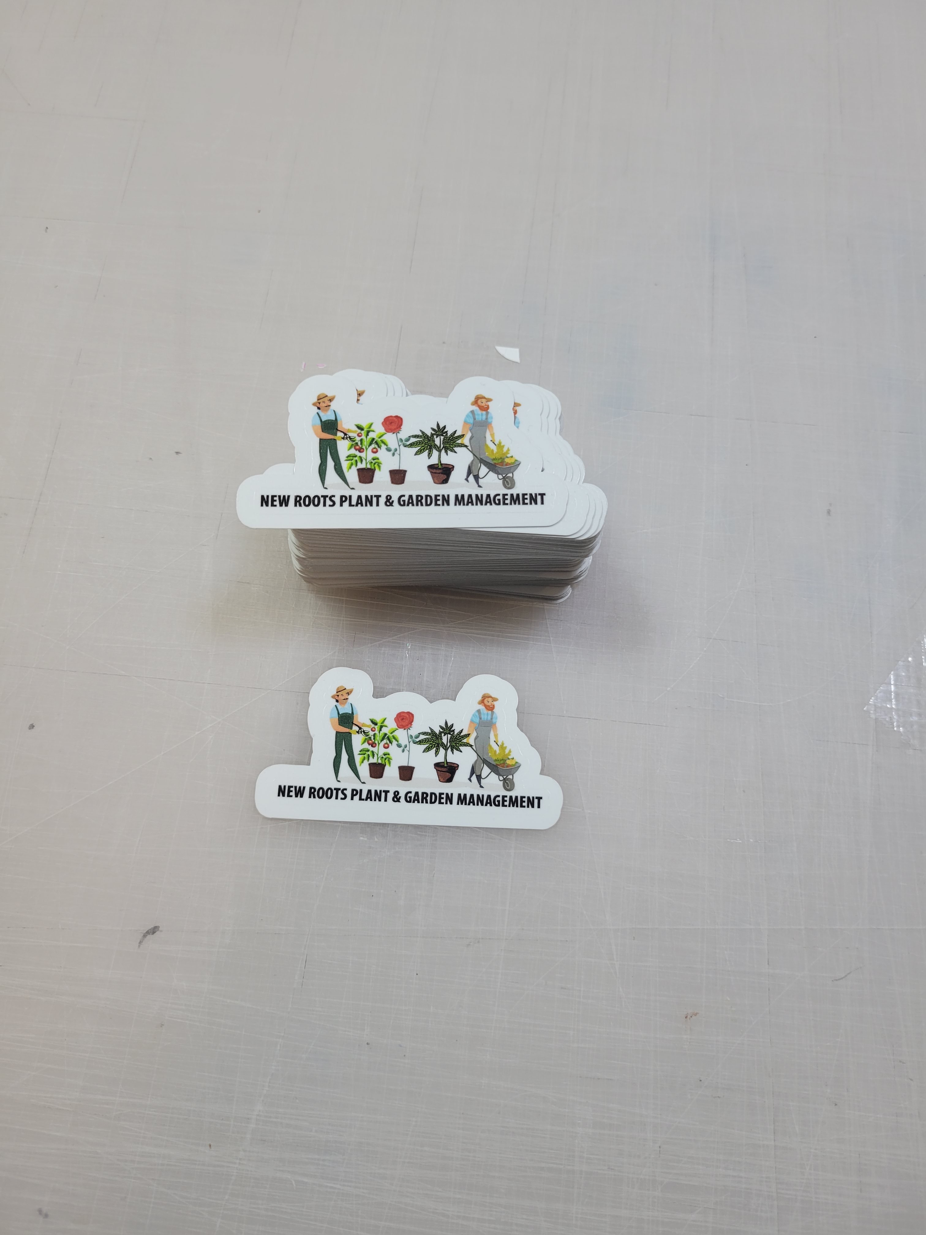

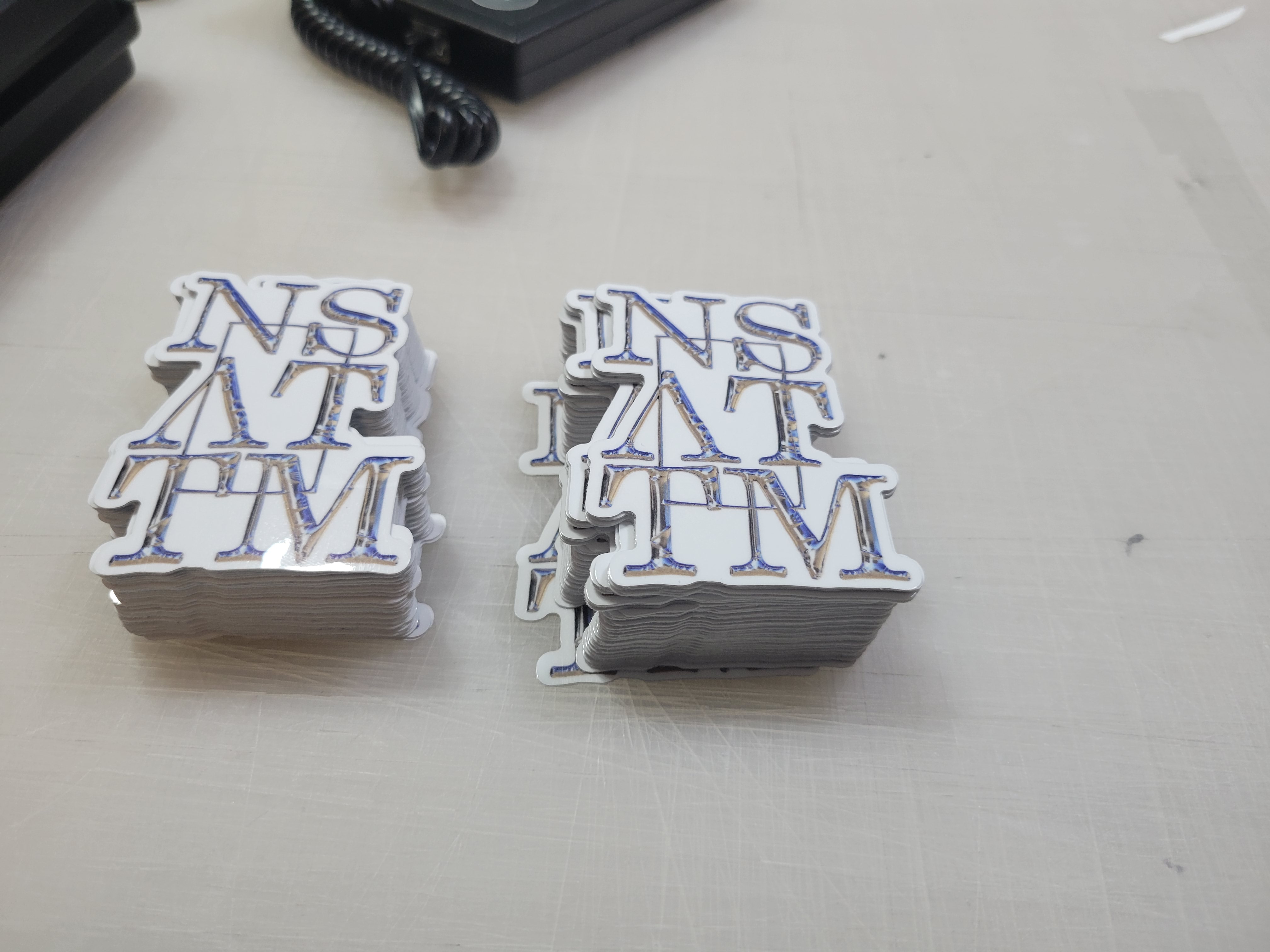

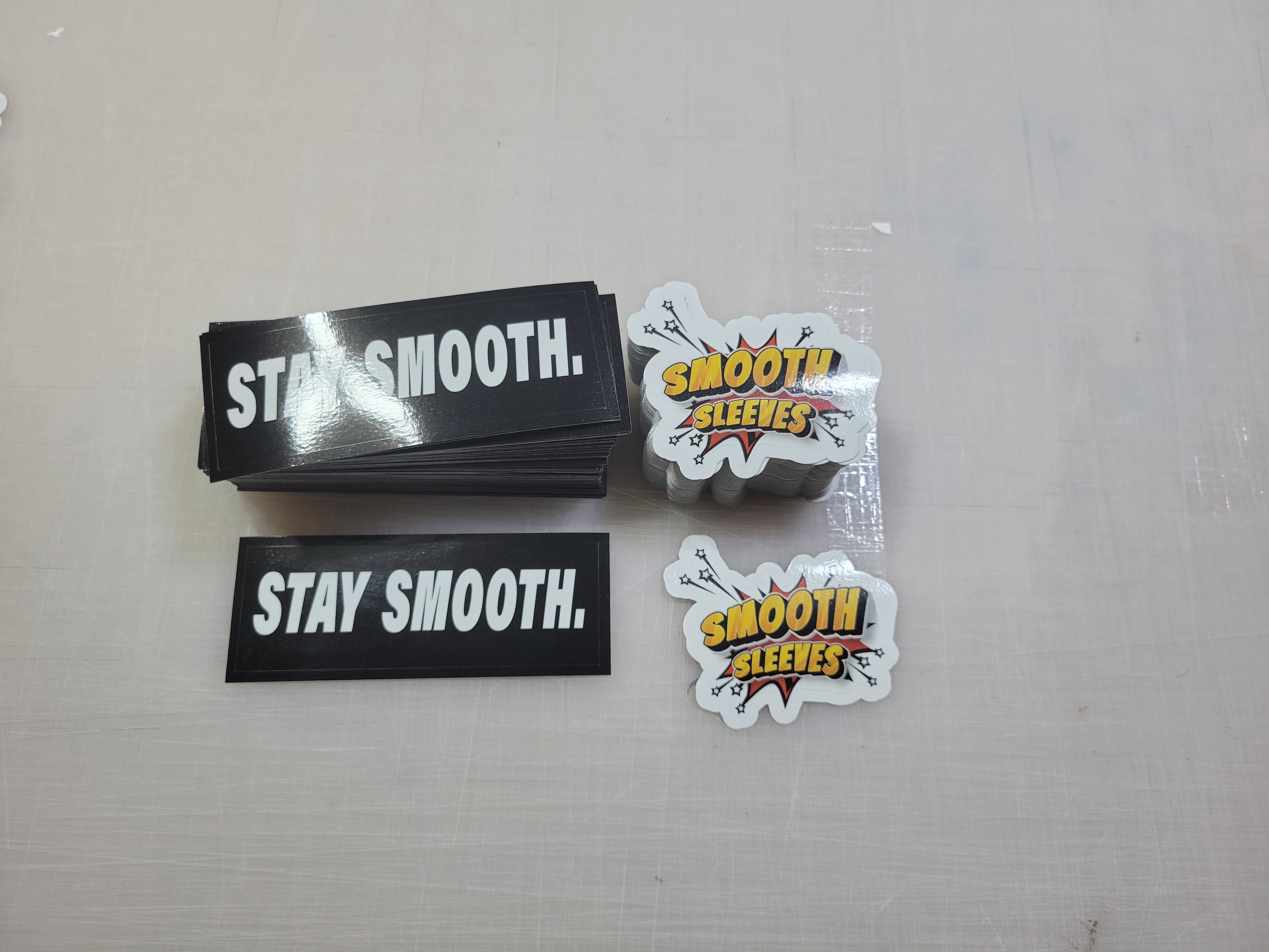

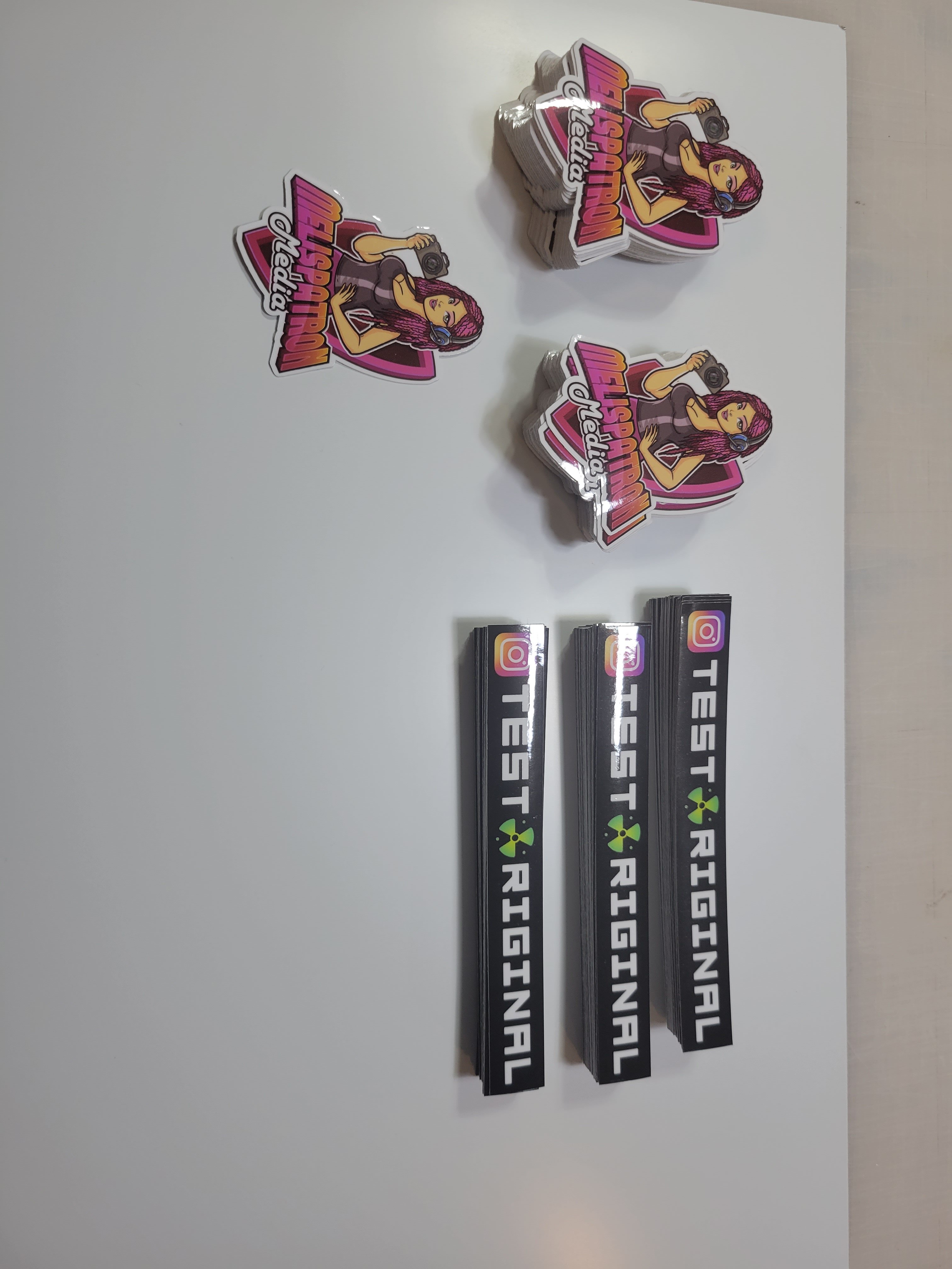

I can't help for the summa. But I can do decently complex curves with perf cutting in the graphtec... Nice smooth edges as well. I probably do thousands a week this way. Can't imagine Making a die for all these 1-200 sticker orders...I can likely finish graphtecing the job before a die is made up. We diecut when we have 100s of thousands of decals of the same shape. But we do roughly 40-60k decals a week on our graphtec with no issue.
  • OMG / WOW
Reactions: 3 users
ikarasu
Ij35 and signmax, I also use 8048 and 8508. For perf cutting I've found the vinyl matters the most... And it's not so much the vinyl, but the backing paper.
I've tried 3M, Avery, cheap stuff .. so far 3M has been a perfect cut with no rough edges. Avery cuts ok as well, but sometimes the backing rips... It doesn't affect the sticker, but still doesn't look as professional. The cheap $80 a roll crap is just a nightmare.
Works on complex shapes, rectangles, pretty much anything. I used to kiss cut then perf cut around because it left a rough edge... But ever since I started using only 3m, I can get away with either since it's so smooth.
Don't judge the artwork... I just do the printing, no design work :D
