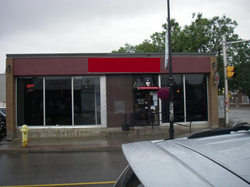

After some helpful suggestions to go to Gemini for lettering, I would like to hear any suggestions on mounting the letters (material type undecided as of yet) on a stucco surface. (Also do not know what is under the stucco at this point)
Each letter will be about 26" high X 28" wide.
I understand that Gemini will supply the letters with studs and a template for my mounting holes.
My next step is to learn what to use as far as adhesives- epoxy, urethane etc in the holes.
