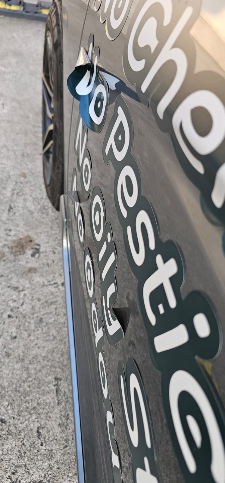

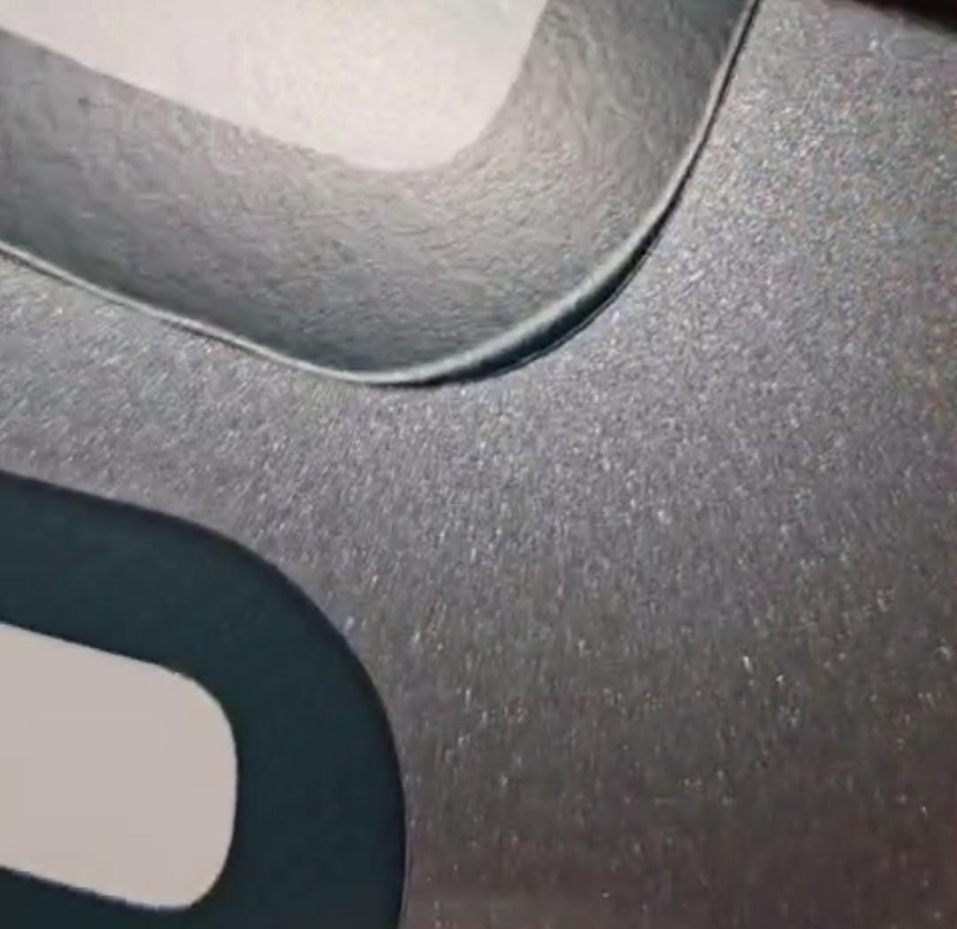

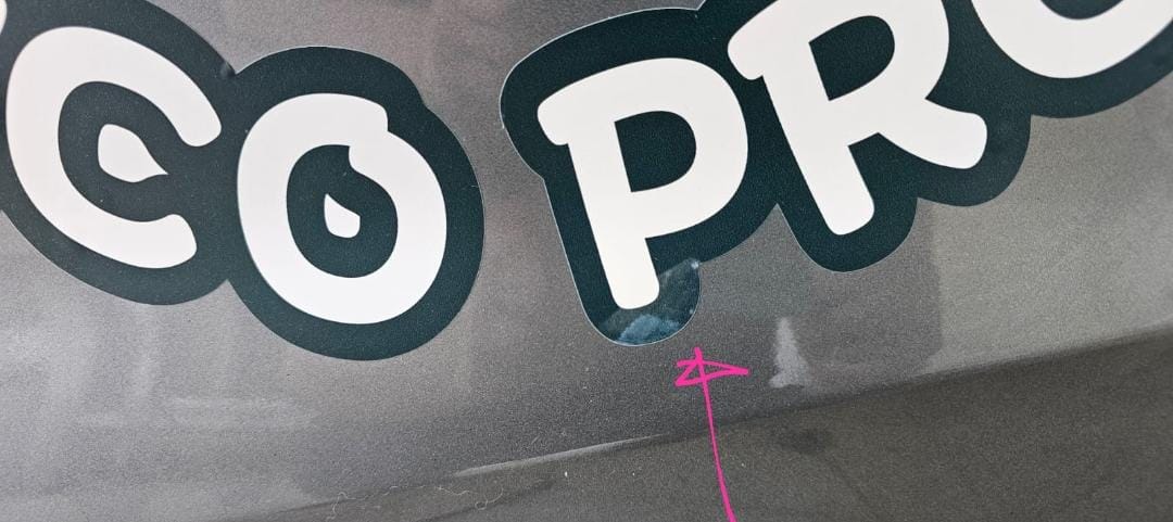

Good day everyone.
Tested and proven immediate prints and laminate for eco solvents is not possible.
Happen to me for testing.
After laminating I apply transfer film. Laminate lift up.
Curls on the edges and leading to whole prints lift off from the car.
