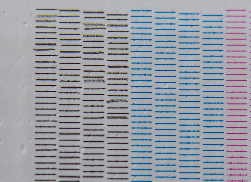

I'm experiencing some fuzzy edges on K-only sections of prints. I've done a manual cleaning and 2 medium machine cleanings, as well as printing a large rectangle of K, and the "soaked swab pressed gently on the head" routine. Problem remains. Does this mean a new head? (This was printed on some scrap banner material).

If you were to print a rectangle 5" x 40", but not a across your 54" width, but into your roll, will the box go off one way or the other, just a little ?? That would probably indicate an encoder strip. If the box is truly square and just fuzzy, I'd say you have a lot of static. Seeing you test strip, looks like something is messing with your head, like fuzz, dirt, static or as a last result, a bad head, but unless you remember this happening gradually, I doubt it's that.
Colin
If you were to print a rectangle 5" x 40", but not a across your 54" width, but into your roll, will the box go off one way or the other, just a little?
I see. No, all is good there. Again, other colors print clean, but the black is fuzzy. I just now received this from a local tech:
"Black side of the head is deflecting, for small print you will see blurriness, I would say 80% of the heads I change are black heads, for this reason. You can try to soak the head in cleaning solution, but it probably needs to be replaced."
I've done all manner of cleaning, so I fear it's a head. It is 4 years old, but not heavily used.

Black is usually the first head that gets damaged due to that it is the first head from material side when your printer starts to print, this is the head that hits first when you have a material strike of any sort....
My black looks similar to your test print.. it's a damaged nozzle...

I have definitely seen people print with worse. If it is an older head (3 years +) it is probably just starting to fail and/or you have had a couple nasty head strikes that are catching up to you. If you can't live with the print quality the last resort is flushing the head but be prepared for things to get better or worse.

Well I just got a new head, and all's well. Nice to have a good dot-pattern back, instead of the dreaded lines. ~$1500.00 - ouch.
The tech said that this occurs from the higher carbon content of the black ink, and not necessarily from head-strikes.

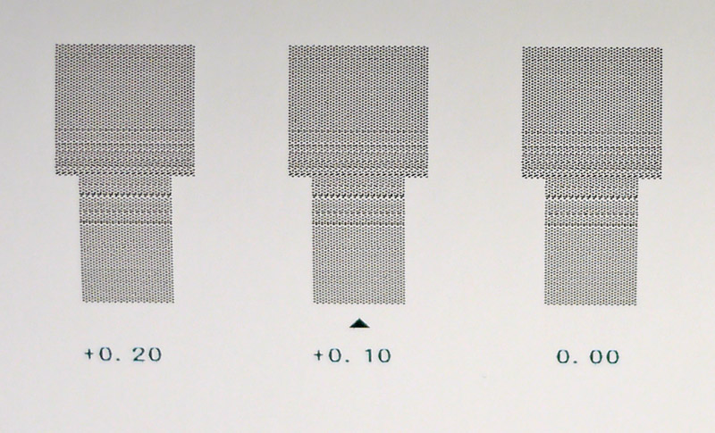

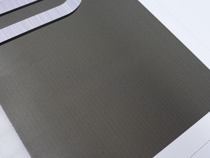

Update on this thread. As mentioned, I got a new K head installed 9 months ago, but it seems to be doing the same sort of thing again, with the banding on RVW-BK grays (see attached). The feed calibration is all set nicely, and what's perplexing is that the other test print doesn't show any deflection.
Anyway, I guess my main question is, what sort of Roland warranty does one have with a recently installed head? I asked the guy who installed it and he said 30 days; that seems awfully short.
Colin
I should add, it prints a CMYK and RGB gray perfectly (although we all know that these are not neutral grays, and have green or pink casts to them). it's only on the more-neutral RVW-BK blacks/grays that the "banding" (for lack of a better term) occurs.
