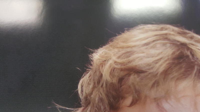

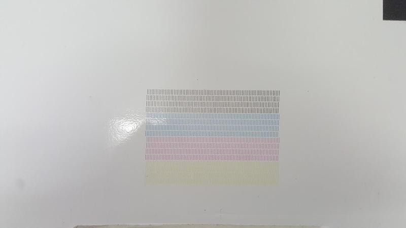

I had a similar problem with my machine recently. When printing photographs, light colors printed perfectly but blacks and shadows had banding, in the same pass. Vector files looked better but you could still tell something wasn't right.
Nozzle tests looked good to me...however trying to calibrate the machine became difficult because the black wasn't printing clearly so lining up little lines and boxes became nearly impossible. This lead to me using a printers loop and that's when I noticed black vector shape edges weren't crisp.
Roland replaced the head (under warranty, the machine is less then a 1yr old) and my tech noticed two issues. First the K head did not line up with the capping station properly, it was justified to the right a bit. Second, the print head was touching the capping station slightly.

I'm no expert either...the tech explained that because the capping station wasn't lining up with the head correctly, that the nozzles weren't being completely covered when the machine was off. It's kinda easy to see if it's an issue, just look at the bottom of the print head.
