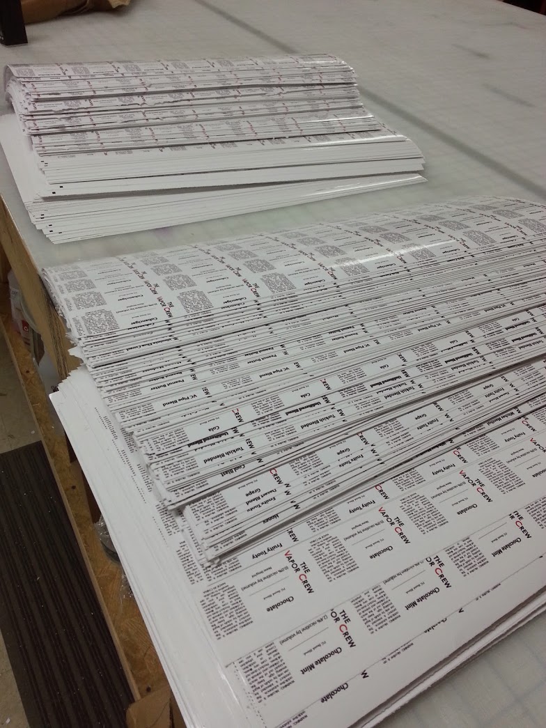

My favorite thing to do is load up an entire 50 yard roll of printed media, scan a barcode, and walk away -- then come back later (or the next day) and have a basket (or box) full of decals which have been contour cut and separated into sheets (e.g., 12" x 54" sheet cuts full of 1" x 2" decals). The best method I found is to break larger jobs up into smaller ones and run them back-to-back. That way the plotter will scan the barcode for each job, find the marks, cut the decals, flexcut (if required), sheet cut, then automatically move on to the next job. (I use Caldera VisualRip+ and a barcode scanner on the Summa). If i'm using the Flexcut feature, then I'll put about 1/2" between each decal and run the jobs in smaller batches (in case something goes wrong during the flexcut pass, I can adjust the next job and restart without being forced to hand cut the entire remaining job). Right now I'm running a decent size print job (about 20 yards of 3" x 6" decals) which involves lots of different address numbers, contour cutting, flex cutting, and sheet cutting (Hint: I use Adobe Illustrator and custom XML files for variable data output and automatic batch creation of production-ready PDFs), then I drag those files into the queue (using a custom workflow I created in Caldera) and hit start. Like anything else, it gets easier once you get a few of these jobs under your belt. ;)
One of the biggest jobs I ran included approximately 123,000 labels (variable data and custom quantities of each label to match client's warehouse inventory meant I couldn't farm it out), That job required about 5 rolls of 54" media. I don't normally get jobs that big (and it's a lot to handle for a one-man shop), but that project was THE reason I decided to pull the trigger on the Summa. Production time from start to finish? Printing + Cutting = approximately 2 days and zero errors!.
I included 1 picture of a partial batch of finished sheets (about 20k labels in that picture). It would have been nice to have a photo of the entire job sitting on the table, but I had to deliver the labels to my customer (2 or 3 times per day) as they came off the plotter (super rush job). Still pretty thrilled I was actually able to do that big of a job in-house by myself though.
