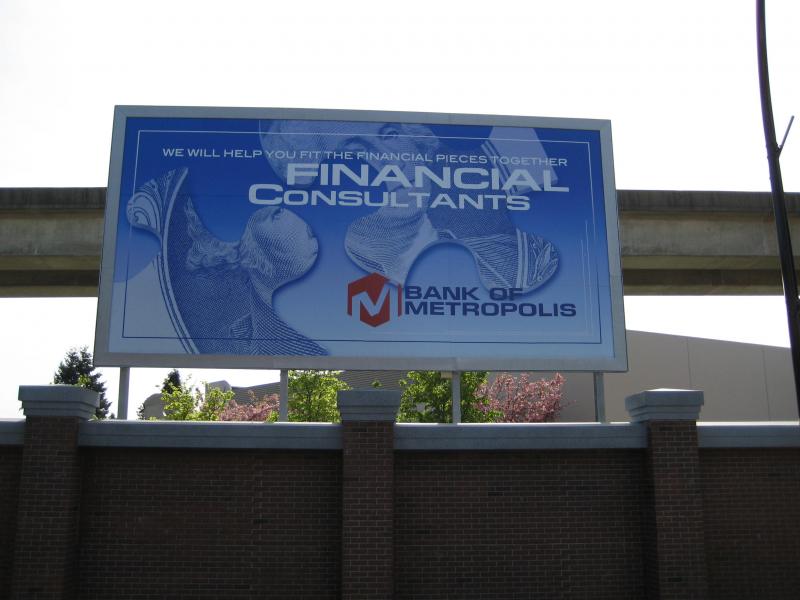

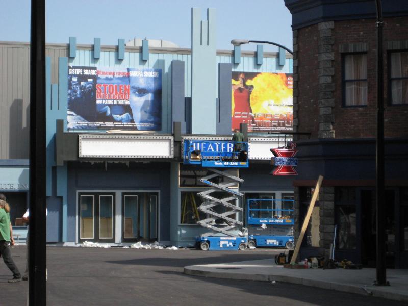

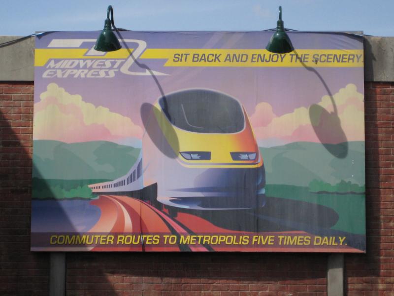

This particular stuff comes from a company called Pony graphics here in Canada. Print quality is ok and dark colours tend to take a bit of time to dry but it is super cheap. It's great for cheapo short term outdoor stuff as long as your comfortable working with wallpaper paste. Just soak the paper with water, roll some glue onto the surface and some on the paper and slap it down. Carefull though, it seems to stretch quite a bit after it's been soaked. Both horizontally and vertically.
Here's a few shots of some stuff I did for the show Smallville a few years back. they actually last outdoors for a ridiculously long time. We start rolling varnish on them to help protect them and they just seemed to last forever. These sets have since been torn down.
