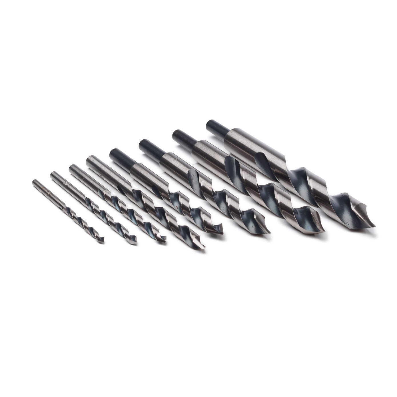

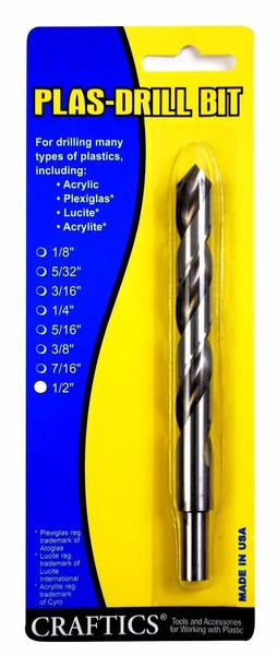

Like what everyone else said. Buy the specific bit for drilling that type of material. I also put a wood board underneath and clamp it down tight. I have not had any cracks since doing it that way.

Drilling plexi has always been risky business. Yeah you need the right bits And even then it's a crap shoot.
visual800
Why waste money on special bits. Grab you a steel bit and just drill the hole slowly, holding back on the drill itself. Work your way up till you can use the step bit and finish it out, its not difficult. Just take it slow
