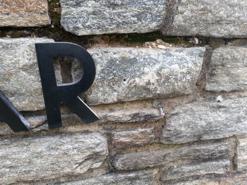

I'm trying to replace a letter that disappeared from this church's sign. The sign is very old and no one had any information where it came from originally so I ordered a custom flat cut aluminum letter to match as well as possible. I'm trying to drill the stone and not having any luck. I've never drilled this surface. I was trying with my cordless hammer drill and a variety of bits(normal, titanium, glass, masonry). I can't get more than 3/8" deep. I'd like to get at least an inch. Any recommendations on what to try? The only thing I can think of is to go back with my corded hammer drill, just trying to avoid it since there is no power close by and my power inverter for my truck isn't hardwired. I have to hook it up at my battery. A picture of the stone is attached.

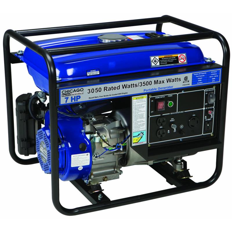

phototec
But you could buy a small generator for that and have quite a bit more flexibility on any job in the future.... like a saw, heat gun, drill, or any other power tool, including lights, a radio or whatever.
Yep, get a small generator and you can use it on any location install.
Here a coupon for a really GREAT deal from Harbor Freight, save $90, half off.
And use the corded hammer drill, it will drill into that stone with ease!
:thumb:
Here's what we recently got to replace our old one.... also from Harbor Freight. This works like a champ. We also have an on-board unit on the rear deck of our bucket truck. That one is much higher HP.
Correct.
I don't remember posting the price, but it was around $385.00 in the store and well worth it. The cordless drills mentioned earlier were over $400 for the little ones and around $700 for the larger ones, so I suggested a generator for less and you can plug several tools in it at once and have several people working from it.

There's zero reason a quality cordless hammer drill with a quality masonry bit won't drill through that stone with ease. If it won't drill a 3/16" hole more than 3/8" deep, then either the drill is a cheapie, the bit is a cheapie, or both.

I have a good hammer drill. I just tried to use my cordless hammer drill since it was only 3 studs. I'll tackle this again tomorrow with my inverter.

What hammer drill are you using and what bit are you using? Again - there's zero reason to need a corded tool for three 3/16" holes.
