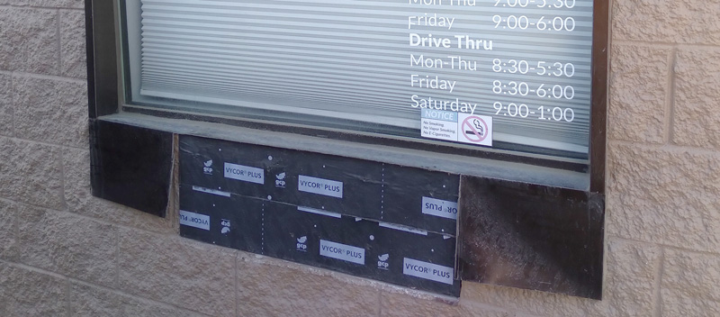

Elementary install question, but what's the best way to drill holes through sheet metal and into brick? Use a regular drill to make a hole in the metal, then roto hammer into the masonry? Customer wants a sign to cover an old bank drawer that used to be in the building. You can see the black metal sheeting that's part of the window frame, which is what I would drill through into the brick to attach the sign. Behind the house wrap material is a metal plate but I won't be drilling into that, just the four corners of the sign (will use ACM). I'm open to any better mounting suggestions.

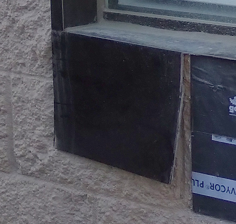

That looks to be about 1/8" thick metal, yeah? You can get a rotary hammer to blow right through a piece of .040" aluminum without worrying about using a metal bit first, but here you'd probably want to shim the piece of metal out with some wood shims, drill the holes in the metal, then come back with the hammer drill. A step bit won't help much here, just the right size bit for the hole. But while we're talking step bits, go and buy a $50 Lenox one, it'll out last 50 of the cheap harbor freight ones... Also don't let anybody else use it!

Regarding adhesion, I might've tried that if the mounting surface was flat, but those metal plates are bowing/flapping out where the bank drawer was, so I need the force of screws to hold it down, or else project it on a frame/stringers like Gino mentioned. It's only about 3ft off the ground.

Dude. Put some sealant around the panel and tek screw it in. If they want it done right, call a mason. It's split faced block too, not brick.

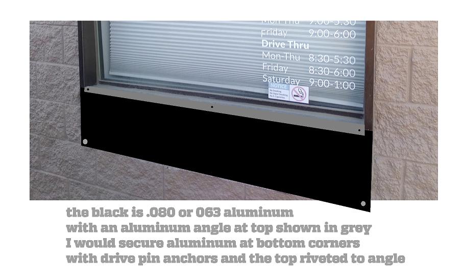

see attached, this is not a job for acm. In my opinion, do it right if your gonna do it.

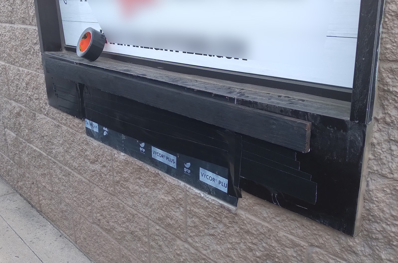

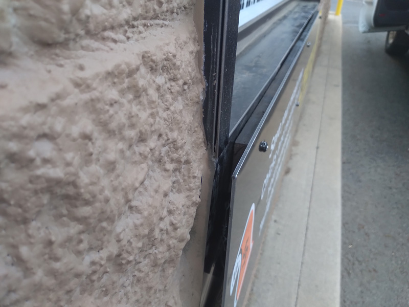

Resolved this the down & dirty way using a couple wood stringers, Gorilla tape, and glue. Screwed the sign to the stringers and done. It was part of a barter so I wanted to keep it simple...never works out that way, does it?
