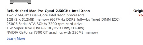

mondo
Come on Rick why'd you have to include that made me more confused.:Oops:
But anyways I've attached what was on Apple refurbished site. It says Quad? 4 Cores?
ITs a good deal actually for $1900. 2 19" monitors and bunch of softwares including CS2. Although some minor scratches.

Rick
Because it is a 4 core (or quad) system by total core amount, not the processors. Apple did call them quad core but in reality they are dual-core, dual-processor when compared to the new quad core processors being made.

The dual core chips are pin compatible with the quad core. Down the road when the quad core chips drop in price you can replace the dual cores and double your processor count.

I just bought one. It has 2 -2.66 duo core processors. Mac calls it a 4 core. Mine was built in January 2008. Hope this helps.
