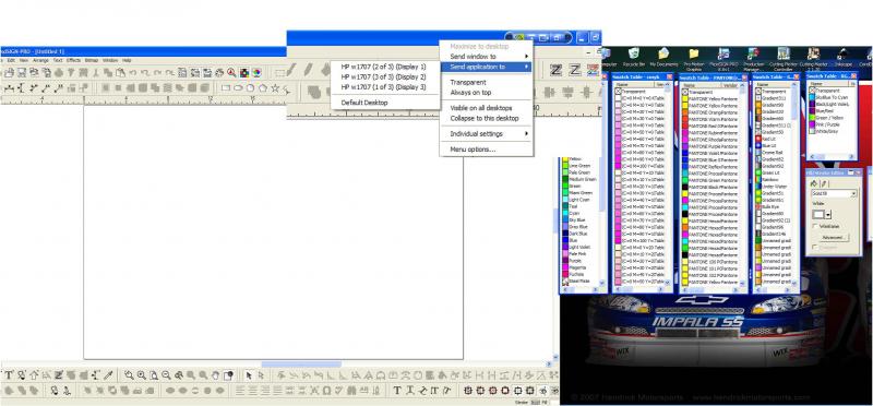

Fred i run 2 dual cards on mine, i run 2 dual G force cards and in the card software mine has all the options to open windows on a default monitor and or any of the other 3 ,so if i want a program to open on monitor 2 i make that program open up on it and make sure you check the box for Move to Application display on the dialog box and also open window on last display.......does your card have software? as far as question 2 not sure

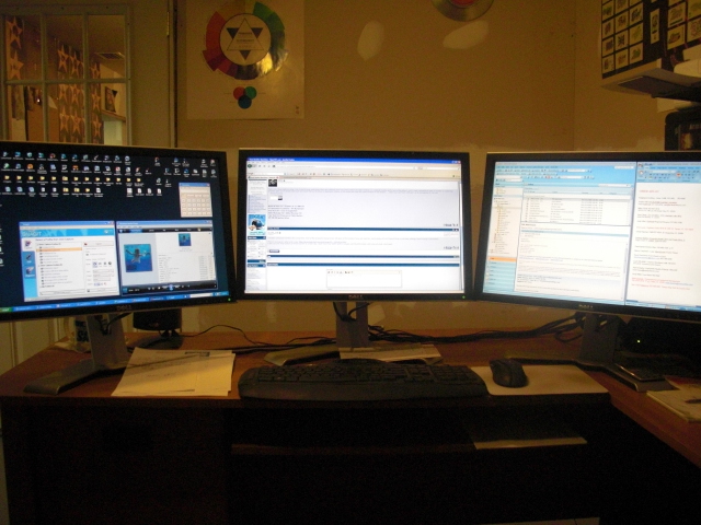

Hehe Fred....Wait til you do a threesome. Your life will become so much more fun!
Move your apps to the screen you want and it will stay there each time you boot up.
Forgot to add. Your keyboard print screen will capture all three monitors at once. I use SnagIt to capture specific regions on any one of the three monitors.
