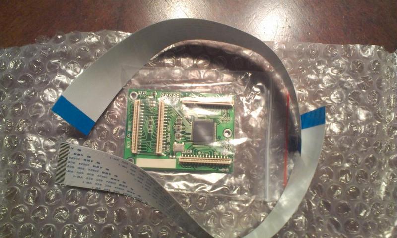

catldavis
Just got in, here's one of the cards to use the newer heads:
attachment.php
I purchased two if anybody wants one please PM me.
