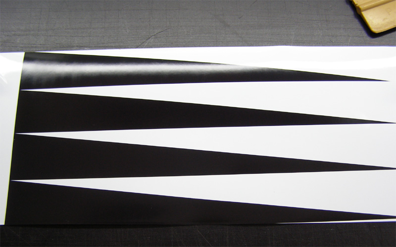

Secondly, I was able to make a "test" print by pressing one of the hidden buttons. I've attached a pic of it. My only real agenda here is to confirm that there are NO blown pixels or any other issues with the printer before I sell it. It appears to me that there are not any blown pixels, based on the great print that I made. Is there a better way to confirm this?? I originally attempted to print a solid, spot black rectangle 6in wide x 11.7in tall. I figured this would be the best "test".

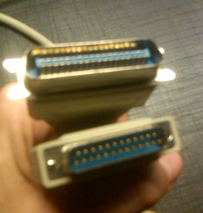

Ok- I now use the ol' Edge Classic, and it's been working fine for months! I took the cable off the other day for a few days- plug it back in today and i now get a "data error" code when trying to print to the edge with Omega. :(
Do these cables "go bad"?? Should i just purchase another IEEE-1284 cable and go from there??

As a rule they don't go bad. The main thing is to keep their length as short as possible.
Have you checked the plot/print spooler to make sure there isn't a job hung up in it that is keeping your current jobs from reaching the Edge?

Yeah, just today i read about the cable length recommendations being 15ft max, which is the length of mine (kinda HAS to be with my current setup). But if that is the problem, I will certainly change my setup!
Anyway- i don't believe there are any other plt jobs in the que.

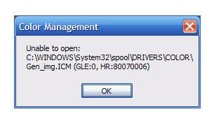

I just opened composer and immediately got this error window (see attachment). I can not continue until I click "ok". I also got the error window when i tried sending a job to plot. And again, I got the same "data error" on the Edge screen.
Before I started getting the "data error" messages, ive gotten a couple other error codes on the Edge which were numbers (I didnt write them down unfortunately).
Does my driver have to be updated or something for the LPT1 port??
If it means anything, this desktop PC has been having problems lately (Gateway GT5220). Little by little, all of the USB ports stopped working. I tried many suggestions via google but to no avail. All 8 USB ports are dead now (and i'm using a serial mouse...lol).
Is the LPT1 port dead now, too? Is the mobo slowly but surely shutting everything down on me??
Luckily, my com1 port must be fine because my plotter still works...*whew!*

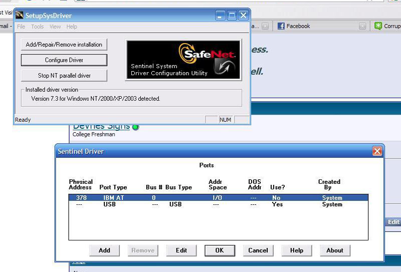

Have you checked the Sentinel Config? It must be set to No for all ports that it sees except Yes for the port where your dongle resides.

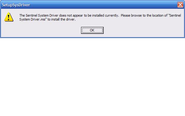

It is incorrect that you got a screen telling you the Sentinel driver is not installed. The screen displaying the settings should not have even appeared if the driver was not installed. The settings, however, are correct.
Please see attached pics.

Just for comparisons sake, I have seen many classics go for somewhere in the $500 range, depending on the head condition. I have one listed on my site that is in very good shape with a perfect head at $2,295...I have had bites, but it has not sold so you probably want to price yours a bit below that. Things that make a difference on Edges...Head age & quality (pixels) clutches, struts (do they hold the lid up) cracks in the hood.
If it has to ship,,,do you have the shipping brackets? If you do not, it can cause an issue.
Best print head clutch tests are 1 foot square prints, medium-dark color (cobalt), one at 50% halftone and one at 10-90% fade. This enables people to see the pixels out and the condition of the clutches (if the fade goes darker then lighter where it should not...)

J Hill Designs
my omega 1.56 setup instructions says The port where the edge or edge2 is attached must be port type ECP and use? must equal no
yours says port type IBM AT
