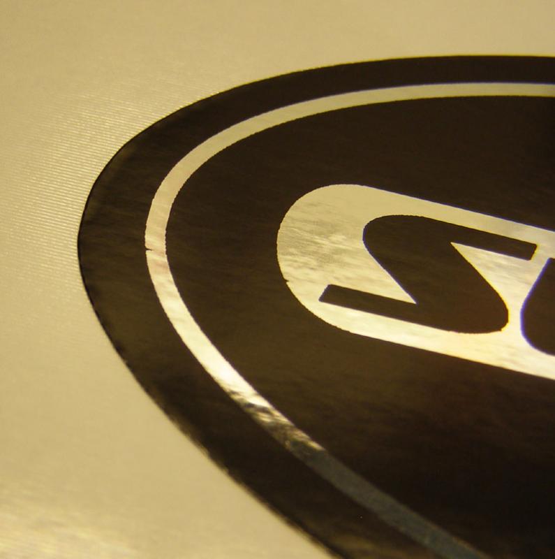

Does anyone know why this is happening? I am printing black on Controltac 250 series and then Gerber silver medal on that.
Why does it automatically leave the area where the silver is assigned to print "open"? It's as if there was a clear fill assigned to those areas, but there is not.
Also- I need to use the Controltac vinyl for it's conformability, so I can not print directly on any solid black vinyl (although that would solve this problem!).
I could live with this if only the registration wasn't SO far off...ugh.

In the pic it doesn't look like the silver is printing clear, just way off register, is that what is happening?
If it is I wonder if it has something to do with the heat settings and/or controltac expanding/contracting and throwing the registration off, maybe even the materials slipping.
You could try printing the silver first either a flood coat or a big overlap with the black overprinting on top.

As Bill said, it looks like a color to color registration problem.
Since it's an older Edge, the first question I have is are you still on the original clutches? That much of an error indicates to me that something is going wrong mechanically.
Other than clutches, your registration is affected by:
  • The comparative amount of foil in each cartridge. The greater the difference the greater the x-axis error.
  • Having "Conserve Foil" turned on in GSPPlot (better registration if turned off).
  • A defect in either cartridge that is impeding the foil from feeding properly.
The first thing I would try would be to run a test print with two other foils to see if the error is still there. If it isn't there then you know its one cartridge or the other.

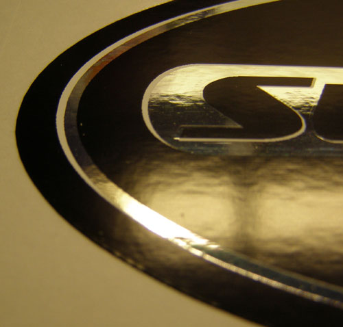

Thanks for all the quick responses, everyone.
Welp, I took the "fool proof" way out and I don't have any more registration prollums...:clapping:
I printed a 11.8in high separate job using black on the white Controltac™, first, and then sent a separate job using just the Silver Medal on top of that.

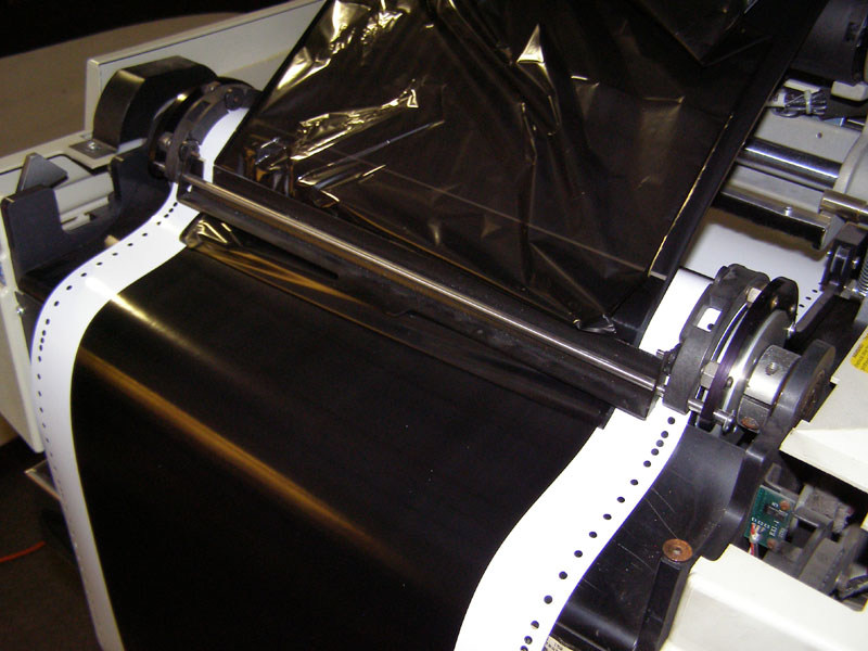

Separate issue- anyone know why sometimes the foil STICKS to the vinyl?? :omg2:
Happens a lot more often than I'd like...

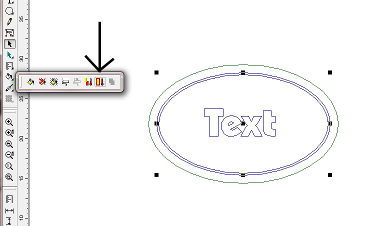

Where foil colors overlap in your designs, the colors will always "knock out" underneath by default.
To change this, select the objects that should print on top of another foil, and click the button as shown in the attached image. This will cause the black oval in the example to print as a solid oval, and the silver would print on top.
No idea about the foil sticking problem... Maybe some kind of heat setting?

but as for sticking, you are assigning the proper materials in omega right?
are the sprockets clean? They should be kept free of adhesive residue. Also, one of the sprockets 'floats' to allow for subtle variations in the width between to perforations in the material... that sprocket needs 2 or 3 drops of oil every 2 or 3 years... or whenever it get's sticky.. these are both good maintenance considerations, that also could possibly be a contributing factor in the foil sticking issue...
