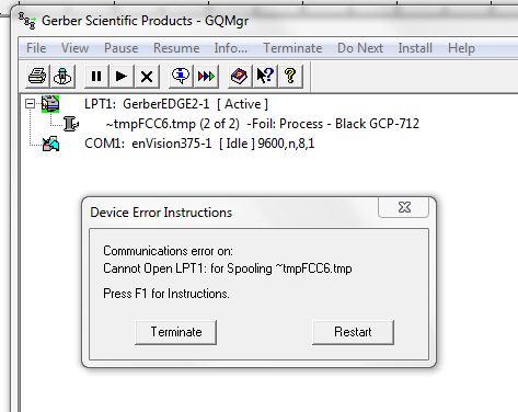

rudeez
This is the error message i get when trying to print with the built in LPT port on the motherboard. Dunno what it means honestly..

Tony Teveris
On the Omega CD/DVD there is a program called parcheck, this will check your parallel port and see if is truely an ECP port. I think it's in the "misc" folder.
As for other parallel port interface cards I think it best for other users to respond as we at Gerber do not test or recommend any boards.
As mentioned above we do have a USB to parallel cable / driver solution for 32 bit OS only, no 64 bit support but that will be coming
rudeez
Parcheck says ECP. As for USB solution, ive read that it dosen't work for edge2 unless you upgrade the software.. Im using Omega 2.1 so, im stuck in a "moment 22" kinda...
