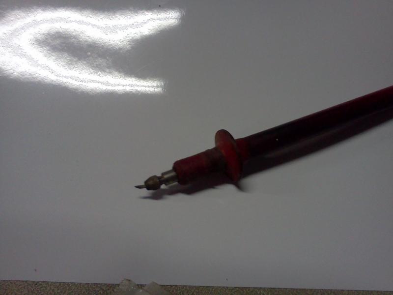

I have contacted some vendors, but they have not replied. So, I am looking to you for some help. Can you tell me if the tip/needle for the Electro-Pounce Jr. is the same as the tip/needle for the Electro-Pounce Sr, or are they different. I don't see the Jr. for sale anymore.

You can also cut the head off of a small finishing nail, round off the tip a bit with a file and use that as a new needle. Works just fine.

I have used both for many decades and we just went to the hardware and bought some small finishing nails for 69 cents and used those and they worked great

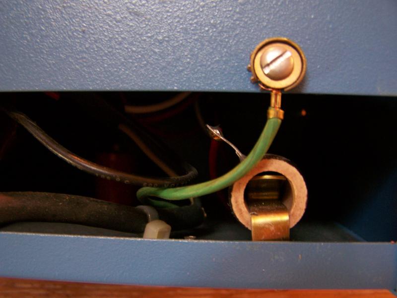

Pounce machine arrived today. There is no ground wire connected. Do I attach it to the screw in the back? What gauge should the wire be?
Thanks again,
TW
