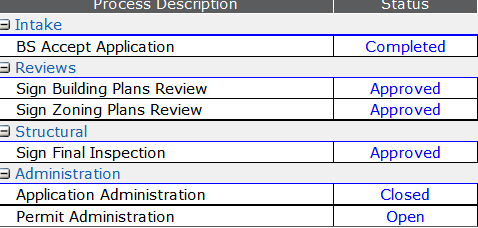

This permit screen shot is for a small (12" x 24") wall sign next to a door adhered with VHB tape and silicone. We have to go through this (minus the building plan review) for even a face change.
Yeah those are normal permit things except yours they break it down into sections. I love how the intake is called BS, because that is what it is!
Building is only needed when the structure is compromised aka engineering.
