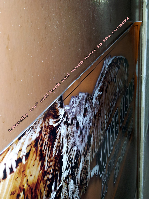

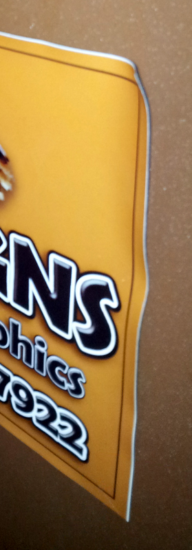

We had an order of 50 come back to us not too long ago with this same problem. We also use Magnum. I will be watching this closely!
Cut a piece off the roll, stick it to your vehicle with nothing done to it and see if it still shrinks or curls. If so it's the stock.
You cannot laminate magnest. The lam shrinks and pulls up the mags. Its not the mags its the laminate. We can clear mags with auto clear and this doesnt happen
This is what I'm talking about. It boils down to.... their product can no longer tolerate what it once did. I know of people who didn't have painting abilities, would take calendared or cast vinyl and just change it by applying vinyl for a color change..... with no repercussions. I can't begin to tell you since 1995 how many magnetics we've covered with full digital prints with no problems. NOW.... all of a sudden, they say you can't do this and never could. So, who the heck is lying ?? I've got almost 15 years in, doing this many many times with full coverage.
Cast lam....it won't shrink.

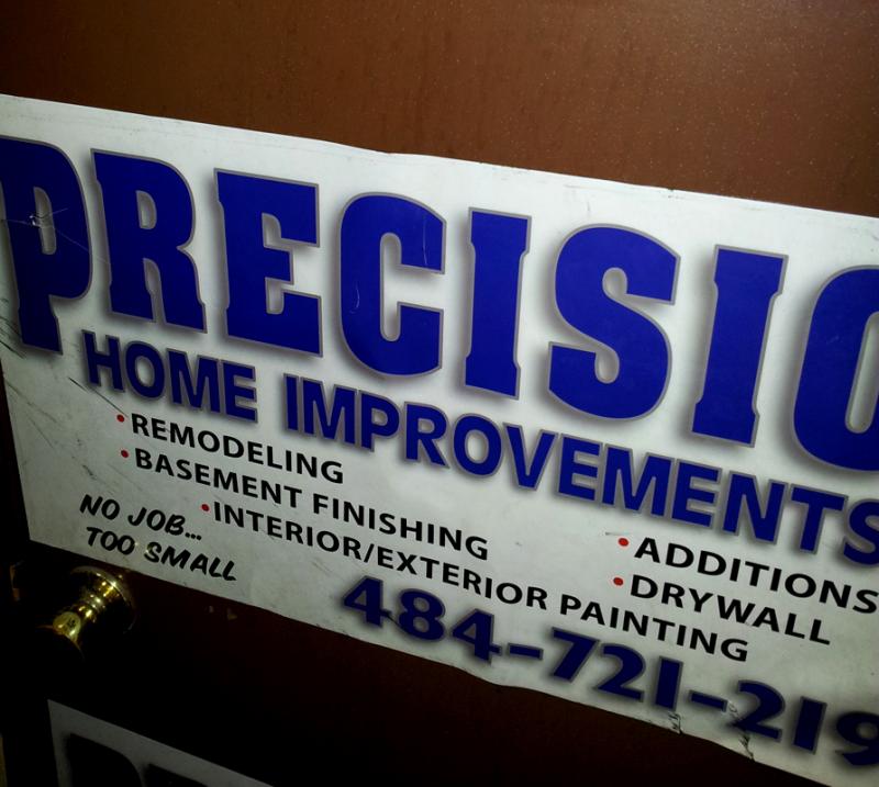

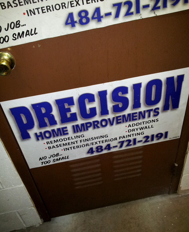

magnet does not stick to body filler or any from of putty also some of the door are a aluminum steel. it wont stick. magum magnetic gave me the same problem one delaminated the white layer. one just did the same thing as ginos. i replaced those already. dont have any pics. i try to sell a sticker. i dont like the look of magnet after a year.If the front doors were made out of aluminum the magnetic wouldn't stick. Maybe this was what happened with this one...?
