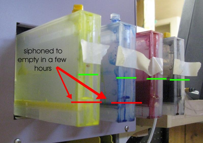

this has happened twice. first time noticed that yellow and cyan were empty. figured it was some odd siphon issue that could never be recreated.
just in case, i put tape at the current ink level to mark progress. nothing for several days. today i go back to see, and the yellow and cyan are once again completely empty.
i did hear a constant drip the other day that i stopped. but i don't remember what stopped it, moving the carriage i think. i was suspicious that this "siphon" issue was happening but too busy to diagnose.
WHAT IS HAPPENING??? I DON'T TRUST MY PRINTER TO NOT DISCARD ENTIRE CARTS OF INK NOW.
(green and red marks are to show the levels from night to morning)

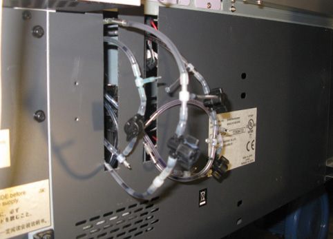

i remember when you installed the valves, but can't remember why you installed them. what are they for again?
artbot
i rarely use my printer. so it has a little more quirks dealing with clogs and such.
also i run my own white water based ink, mimaki ss2 white ink, uv clear, and solvent clear. all of which are a bit higher viscosity and clog factors. the valves allow me to keep up with the issues that would not normally happen with a stock setup.

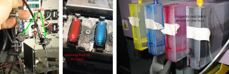

i've resorted to assuming that the ink was gone from the black and magenta before i turned the pump valves to "off". i still need to know better what i did to cause this. i'm now constantly checking to see if my remaining ink has disappeared.

thanks for all the advice. i think that when i do the head soak, then go around back, turn the pump lines back open, and then walk away, it cause the ink in the line to just siphon away.
maybe if when i open the pump line back up, i should pull the head carriage over to allow the caps to drain. that would break the fluid chain from the cart to the cap.
