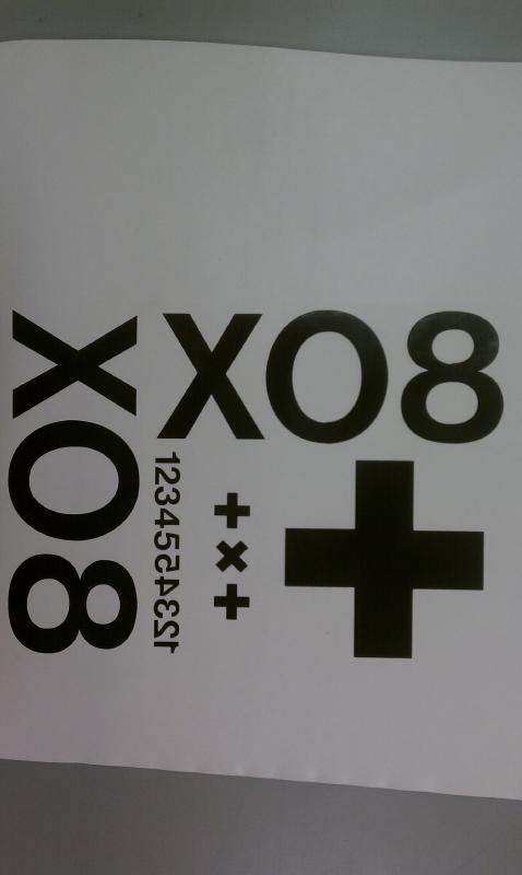

I have two Envision 375 plotters, one of which is literally "right-out-of-the-box".

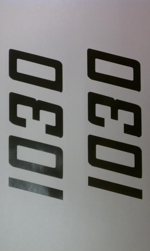

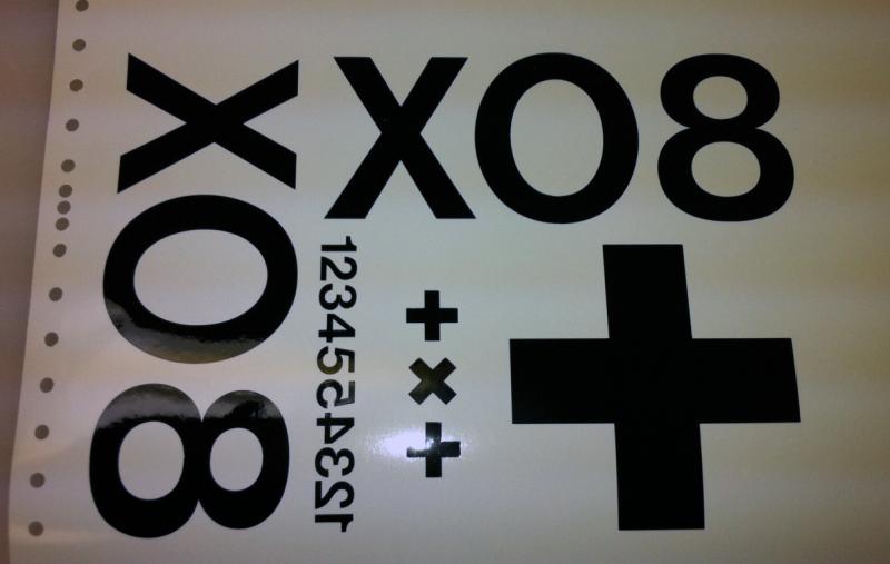

They both have the same problem - they fail the X08 diagnostic test. Specifically, the start and stop cut lines on one of the "0" and the "8" do not start and stop at the same point - the result is a "pull" when weeding that looks terrible. See attached X08 test and an example of how it affects a typical job. I've gone back and forth with Gerber Tech Support and their engineers are "working on a solution". (At first the couldn't believe that a new plotter would have a problem).
Here is the kicker - My distributor volunteered to give me a loaner. He ran the test on his plotter before he brought it over and it failed the X08 diagnostic test too!! Obviously, we now suspect this problem affects more than the three plotters in question.
Anyone else have this problem?
To run the test - hold down "enter" and press F3 to access the hidden menu. Run diagnostic tests. Let me know what you get. It would be much appreciated.

what type of vinyl? check your punch holes. hole stress could throw it off that far. if possible, run the test on a poly liner like 225.
