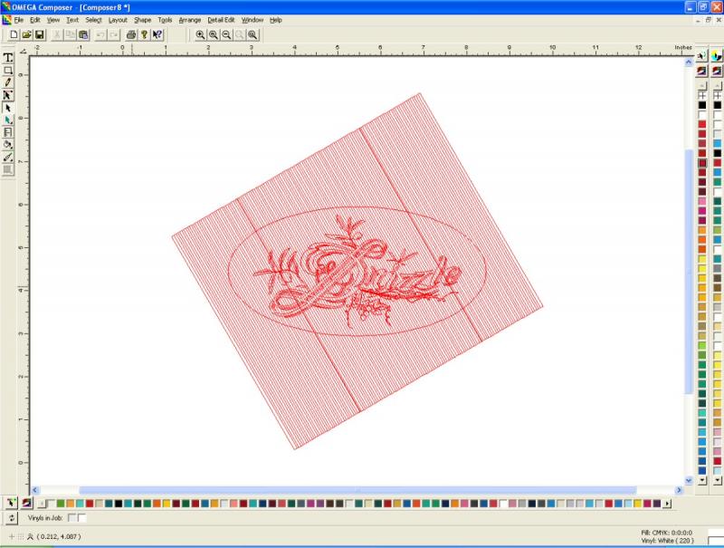

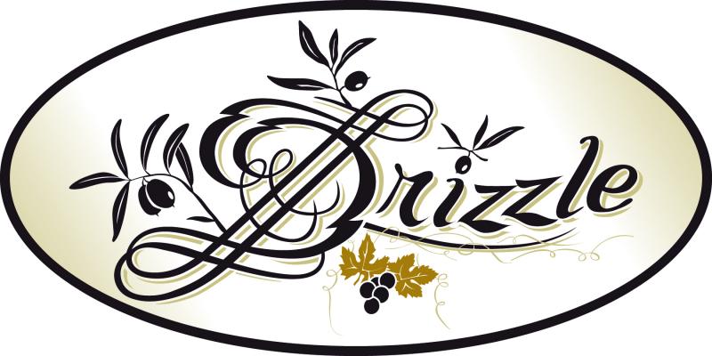

OK heres what the imported eps looks like in omega - and what it looks like from illy - the real problem is you have to recreate your gradient in omega...but on the other prob, colors imported just fine on my end...
what I would do for 1 is convert the black outline to curves, make the inner oval white, reexport, import into omega, set the white oval with a gradient created in omega, select different fills (by select -> process colors -> fills) and assign spot colors to the elements...if you are printing as process, it should be ready to go though

hmm so yeah i got his file, sent an eps back to him that opens fine in my omega (1.56) all colors there etc, but when he opens it all shapes are white...something going on with omega...the .plt file I created and sent to him opened correctly on his end...
I'm stumped
