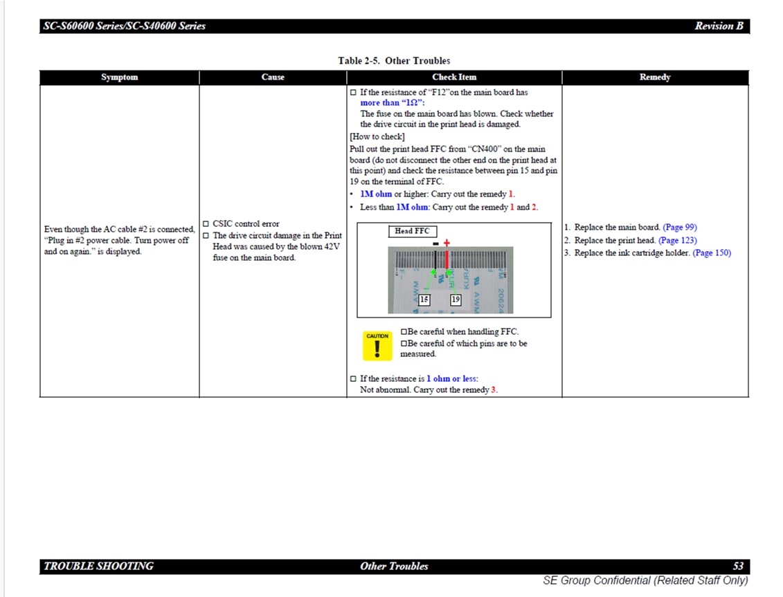

Good morning, I am working on an Epson s60600. Replaced printhead #2 for missing black, cleanings wasn’t helping any. Machine was working ok besides missing nozzles. Followed all step with service tool and service manual, purged lines with cleaning solution, decompress pressure, Shutdown and unplug. After replacing on boot up I am constantly getting plug in powercord message. I have tried resetting cables no change. Any help or suggestions would greatly be appreciated. Thank you

2 plugs for machine and a third plug for heater. I didn’t unplug anything but the ffc cables for the printhead. I am assuming something shorted and it’s either power supply is bad or mainboard.

The same thing happened to my Epson when the tech guy was repairing it. I think he just put in another mainboard and printhead. Attached is a page from the service manual. Wish I had better news.

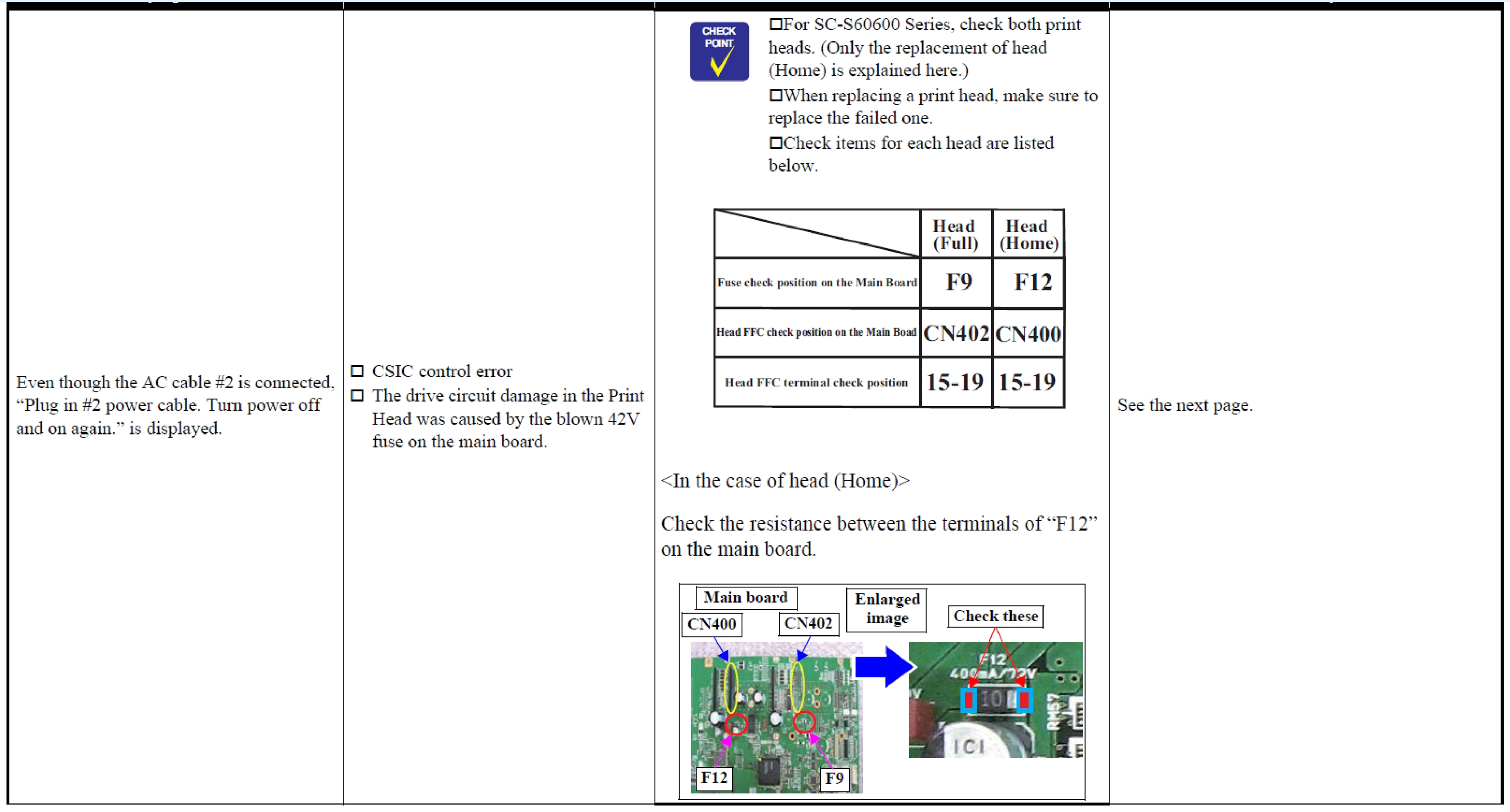

if it's a fuse i guess you could replace that fuse to repair that mainboard instead of costly replace that MB? Does anyone has the specs/location of that fuse so the OP can check it out?

Here is another page from the service manual.

thank you all for all the info. I have tried switching power cables. I will go back and test the fuse. Thank you for the images
