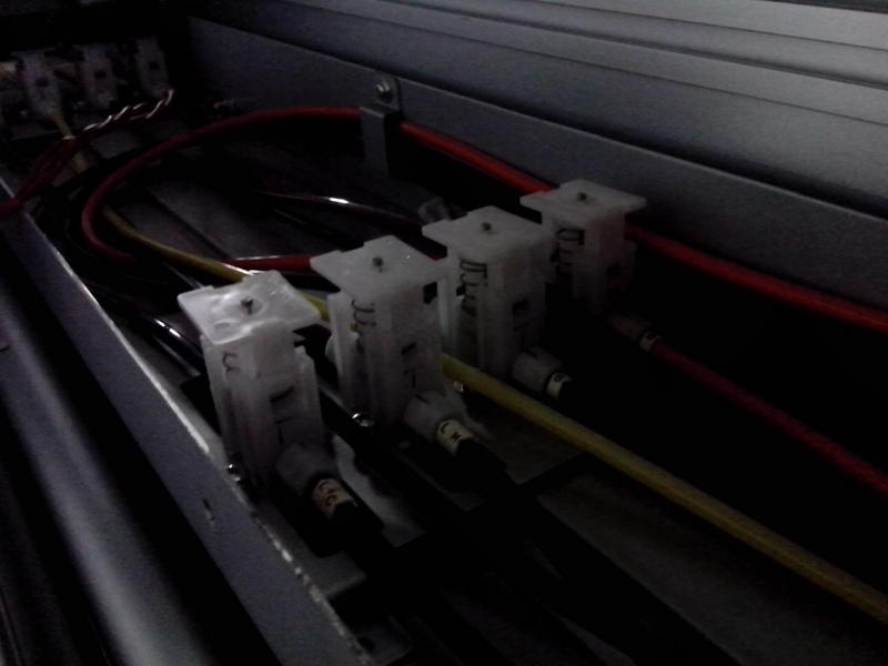

After you can see 2 valves assy (one for each head) : see photo 1.

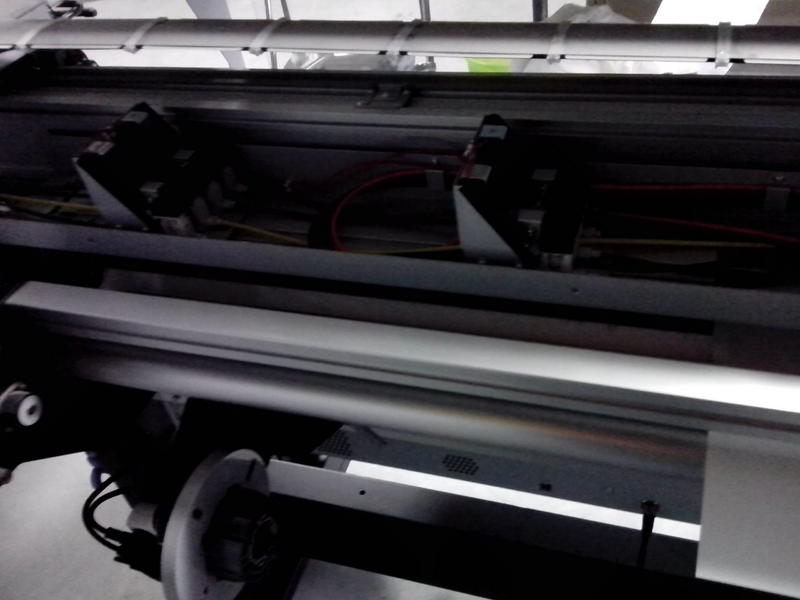

Trek the solenoid (4 screws) : photo 2.

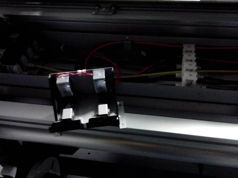

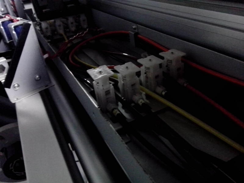

Raise the 4 plastic parts : 1 by color (see photo 3 and 4).

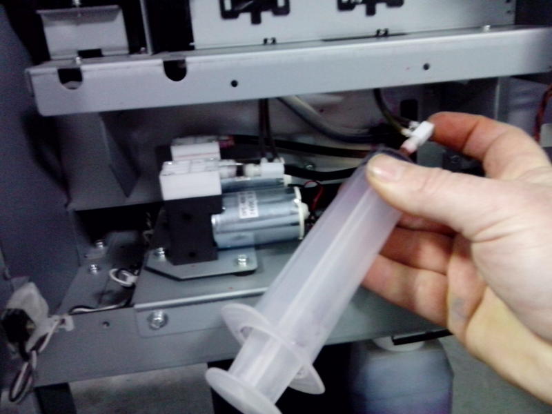

After pull the pipes at the entry of the pump and aspirate with a syringe.
When the pipes over the head is full and ink flow in the syringe. it's ok. (see photo 5).
Replace the pipes in the pump and the platic parts.
