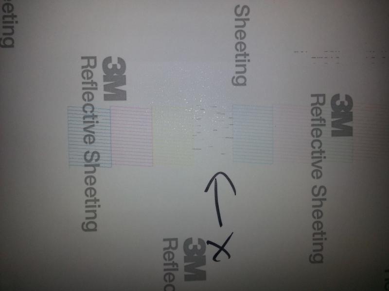

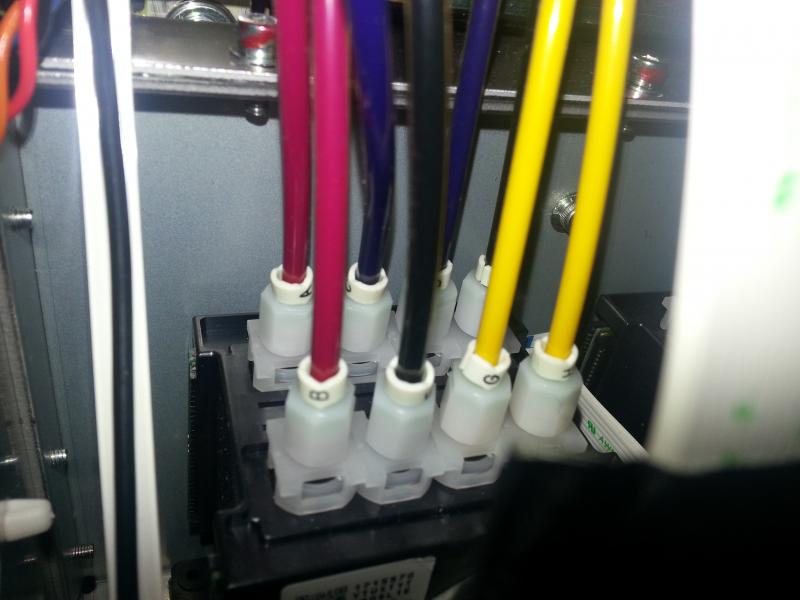

We have an epson stylus pro gs6000 that will not print black? Problem started right after doing a head wash to unclog the green nozzle/ink line. It did successfully get our green to print but consequently blocked our black from printing (See the nozzle check picture attached). FYI It's an 8 color printer CMYK-LC-LM-O-G. I thought it maybe a dirty print head so I cleaned them off with the solution kit. Didn't work. Then I read on a post it could be a vaccum leak. I opened up the panel and found an air pocket in the Black Ink line (see picture attached), all other lines are solid color (no air pockets). I then proceeded to do some cleanings (Light/Med/Heavy) to see if it would suck the air out but none did the trick. Last idea i had was maybe the cartridge was defective, so I tried another black ink cartridge, no dice. Any idea as to how to fix my black ink line? I don't want to do another head wash because that requires another 8 cleaning cartridges at a price of $495+...

If the air is showing up by the top of the head, it could be a leak in the damper or the connection to it. change out the damper. contact me if you need a source for them.

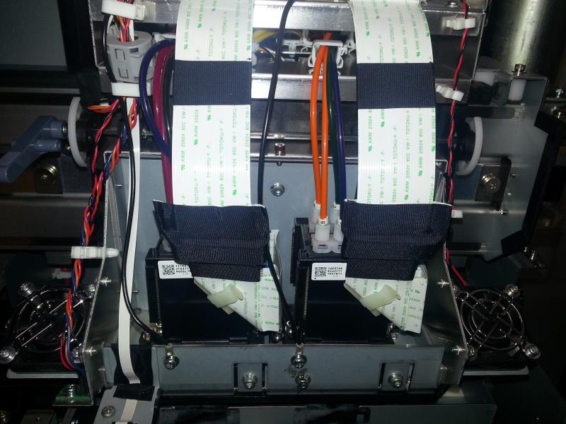

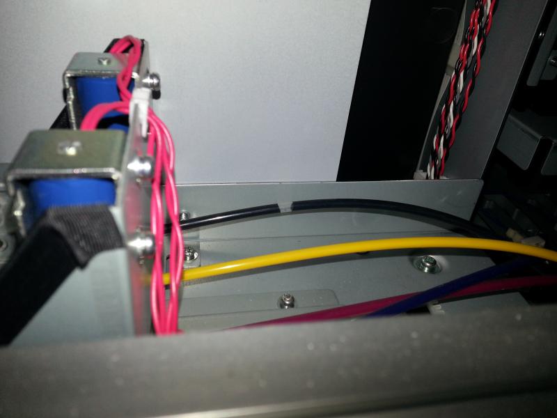

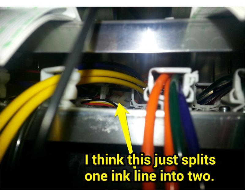

Noob question but I can't seem to identify the dampers. I did a quick search on google and the forums. I attached some pictures of the print carriage where the lines run. Maybe i'm missing something.

Nevermind I found them. They are actually beneath a case mounted on the printhead. Looks like i need to remove the printhead to get to the small latches on the side to remove that case. I have a pdf guide on how to remove them if anyone needs it, except it doesn't say anything about installing new dampers. Maybe someone can chime in on that procedure...
