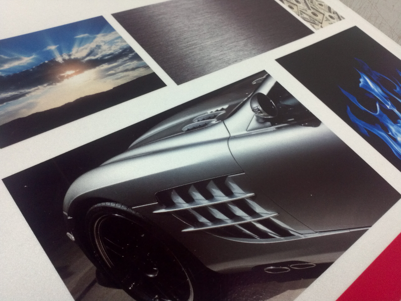

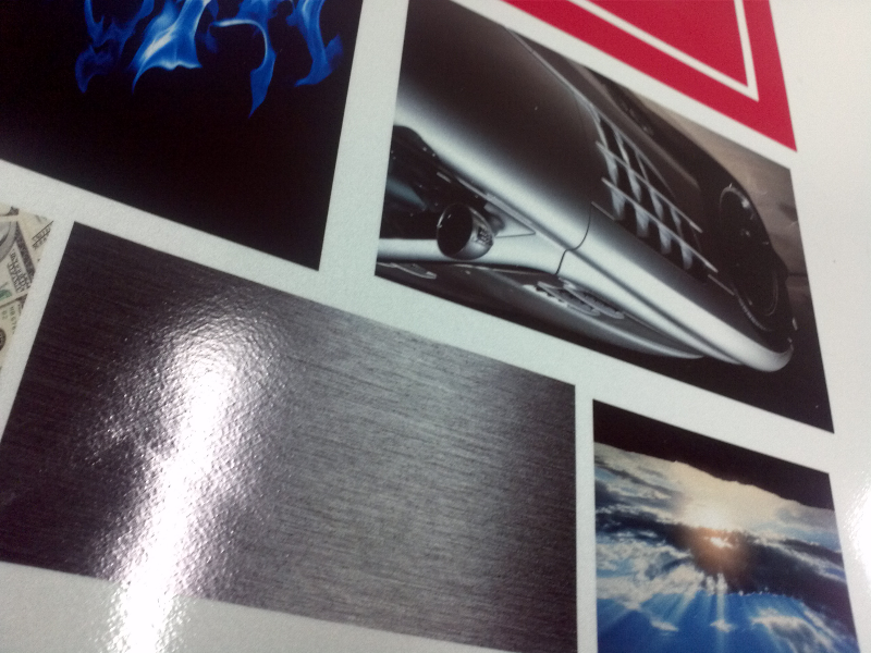

Hey. I recently got a short roll kit from 3m. And they had a small roll of reflective in their....prints really nice.may i ask what profile you guys use? 3m didn't have a profile for my cjv30?.... i cant wait to do a job with reflective. I gotta say. As i was printing i noticed some junk inbetween the media. I figured it was because of the short roll. Anyone have this problem on the bigger full rolls?
ironchef
Here are some pics
