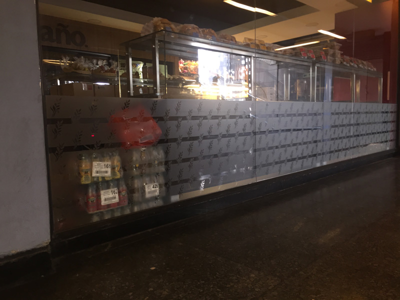

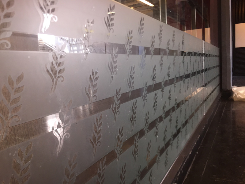

Hi, We're making a lot of frosted installs. We use Metamark brand.
We use clear transfer.
Its a complex design, it takes a lot of care to peel of the backing liner. We use just tap water for installing, saturating both glass and adhesive. After install leave the transfer for 24 hrs until dry, peel it and squeeze using a felt pad. There are some air bubbles but they go away within a couple of days.
I like to try Rapid Tac but its unavailable here in Chile. Some use a solution of gentle soap with water, but the plain water just do the job.
