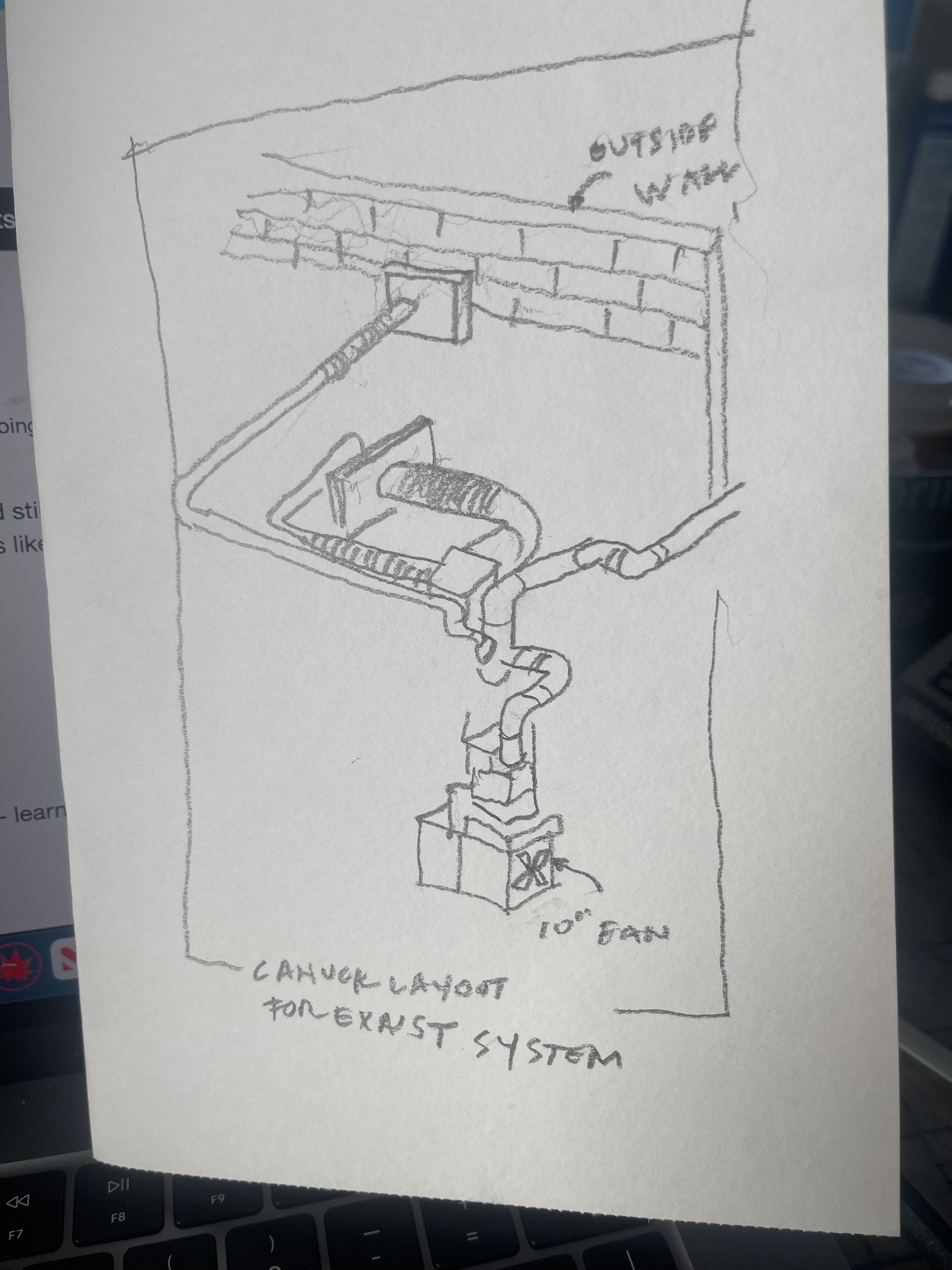

I'm hoping someone here can shed some light on a question I have. i currently have an exhaust fan in my print room, I will be adding another piece of equipment that needs venting. The current fan is a 6" duct fan, outputting around 430 CFM. would I be able to replace the fan with an 8" one and add a 8"->6" reducer for the final 4' run out the back wall?
the setup would be"
8" pipe for about 15 feet, into an 8" inline fan, then a 6" reducer then 4 feet of 6" pipe out the back wall.
Cutting a larger hole in the back wall is not an option, landlord won't allow it.
i know the reducer will create a bit of a choke point, but if the 8" fan is rated for 900CFM, would it still pump out more air than a 6" rated for 430CFM?

the current print room is about 15'x20' with 8 foot ceilings. the current fan just helps to get the ink smell out on long print runs. I will be adding a laser cutter and am hoping to tie into the existing duct work that runs out the back of the building, I'm wondering if swapping the 6" fan @ 430CFM to an 8" fan @ 900 CFM will have any benefit if the last 4' of ductwork is still 6" or am I going to create a bottleneck?

They make 10 to 6 reducers. As far as causing issues, not sure what you mean. I would think more air being sucked out the better.
the issue i'm asking about is if a 10" fan blowing into a 6" pipe is going to create a bottleneck and cause less air to flow through than if I just stuck with a 6" fan in a 6" pipe
I don't think. But even if it did bottleneck it, a 10" fan would still put a 6 inch fan to shame. The CFM is just so much greater it's a huge difference. And yes like netsol said, fresh air intake from somewhere is a good idea.

The fan should be as close to the machines as possible- learned my lesson on a 130w Laser burning plastics.

Not anything I've studied, but experience tells me that the air flow will just be faster while pushing through the 6" exit point ( like pinching a garden hose to get water shooting out farther ) - but the overall system upgraded to an 8" fan would certainly be evacuating more air.
Only downside I see is that the 8" fan will work a bit harder since it does not have the optimal exhaust port, but hopefully the fan can manage the 25% reduction - if you had to push through a 50 ft long exhaust pipe it would probably add comparable strain ).

it will raise pressure in the pipe.
STILL vastly better off with bigger fan even with a smaller pipe
We just installed a 130W a couple of months ago and have one of the 8" AC Infinity fans CanuckSigns is looking at. Man that thing moves a lot of air!! It's mounted half way between the laser and the hole in the wall - I would think you want more pull than push, assuming everything between the laser and the exhaust outside is air-tight? (Seems to be lots of conflicting opinions on this, from what I've seen)
We did recently realize that we had quite a bit of fumes leaking out between laser and exhaust - paid a good chunk of change for a HVAC company to set up some nice ductwork for us but they still didn't seal all the seams, and the flex tube going from unit to rigid tube had enough slack that the AC Infinity fan would just about suck it shut. We cleaned things up a bit yesterday and I think we've improved the airflow and reduced the amount of fumes leaking into the shop, it was getting pretty bad after a full day of running lamacoids.
CanuckSigns : You could always just run your theory by an HVAC guy - they'll know the answer. Assuming you just want to do the work yourself, it might be worth getting someone down to have a quick look/consultation even if you have to pay them for an hour. Otherwise just build it and test it out, can't hurt.
I'm not expert but I think you will choke some of the airflow, but it will still work. Those AC Infinity fans are insane, I've never seen anything like it.
Is there any way to plumb this setup into your laser exhaust ducts or different area of the shop? I've seen that, were people have multiple units all connected into one central exhaust.

I started with the AC Infinity 6 inch. It was ok nothing special, but I felt like I needed more power. I upgraded to the 10 inch and it's like a mini jet engine.

I second the AC Infinity fan! These things are AMAZING, cheap, they move a TON of air, and they're relatively quiet compared to the BUZZ and RATTLE you get with most cheap, stamped galvanized fans. I have a single 12" fan in my 1200 sq/ft print room, and I have mine reduced down to 8" and it moves a LOT more air than just a 6" alone. I found that you kind of NEED a little bit of reduction in the output ducting in order to increase the velocity and get the air to MOVE. Once I put the reducer in, I lit a cig in the area below the intake duct, and the smoke moves up toward the ceiling and when it get's within a foot of the ceiling it's quickly sucked toward the intake grill and out of the room!
I also bought a couple cheap electric dampers, and hooked them up to the intake side with a Wye adapter, and I have the first run going to a ceiling grill above the printer, and the second run comes out the ceiling via flex duct and runs directly into my Laser Cutter cabinet.
I can run the fan on full speed with both dampers open, and it still clears all the smoke out of my laser cabinet, but most of the time I only run with 1 damper open (above the printer) and the laser damper closed off, to help increase the suction in ceiling intake. I have both dampers hooked up to a cheap doorbell transformer and wired into a low voltage swtich box with a couple of toggle switches mounted in it (one for each damper).
As long as no one accidentally closes both dampers, it works GREAT!
AC Infinity ALL THE WAY! (Go with the 8 or 10" and reduce it down to 6" as close to your external wall as possible).
Keep in mind you can easily control the fan speed with the included controller, so I would go with the bigger fan, and you can always slow it down if it's too much (which it won't be).
a side note, after installing the AC Infinity at my shop, I went on amazon and bought 2 more of them (another 8" and a 10") and installed them in my HOME because I was THAT impressed at the build quality and performance. One in my bathroom (with the optional "muffler" to make it quieter), and the second one in my attic with their optional smart controller that automatically spools up the fan if the temperature or humidity level hits my pre-set point, my attic has never been drier, and it helps keep the house cool in summer by sucking the HEAT out of the attic space!
A tip, to reduce the noise, remember to install it by suspending it from a ceiling joist with cord/rope, and to reduce the "jet engine" sound of all that air moving, remember to keep your duct runs as straight and smooth as possible! Don't use ribbed flex duct, use smooth galvanized if you can, and mount the fan away from your ceiling intake grate if you can. I mounted the shop fan in another room, so the only sound I hear is the air moving through the ceiling grate, it's not a "fan" noise, it's more of a continuous "whisssshhhhhhhh" sound, like a commercial AC duct sounds when it's blowing.
