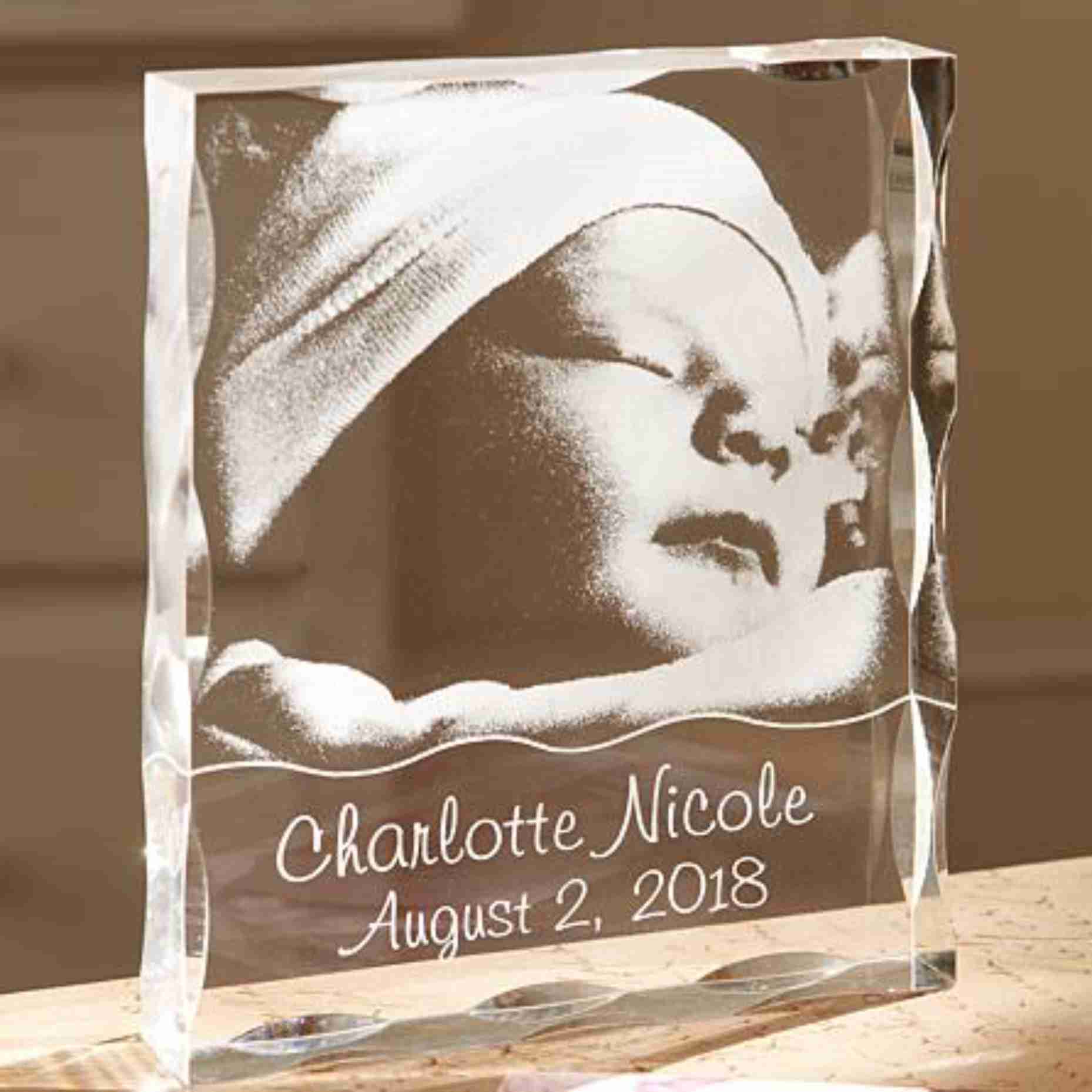

A halftone image etched into glass..something that looks like this... Maybe direct surface printing would work.

Laser etching photos in glass is hit or miss. The picture you posted is a completely different process. That is subsurface engraving in crystal. Way different process.
Laser etching photos is about controlled fracturing and getting that range of greyscale without chipping is tricky. Arguably the most difficult thing to do with a laser. If you need to stick with glass, a sandblaster would likely be the better way to go. They can't quite get the detail, but the consistency of the etch is superior.
If you can, switching to cast acrylic is the better way to go about this project. You can do that on a laser engraver and it's a fairly straight forward project. You just need to find someone with a large enough bed. 24" high is a little tall for your average engraver.
