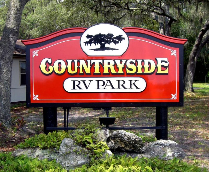

Doug, I've used the Extira on several projects with no failures. It will require painting and the specs are on their website. The only drawback on larger projects is weight, the stuff can get pretty heavy when working with 3/4 and 1" thicknesses. The letters shouldn't be a problem other than the time to get a smooth finish if it's that critical.
The black background on this sign is 1" as well as the molding trim I made for the top. This sign weighed a ton when it was done. It's been up five years now and the last time I checked on it, still looked solid. The one thing about Extire versus PVC is expansion and contraction. Paint PVC a dark color and use in a warm climate and the stuff comes to life, so take that into account.
