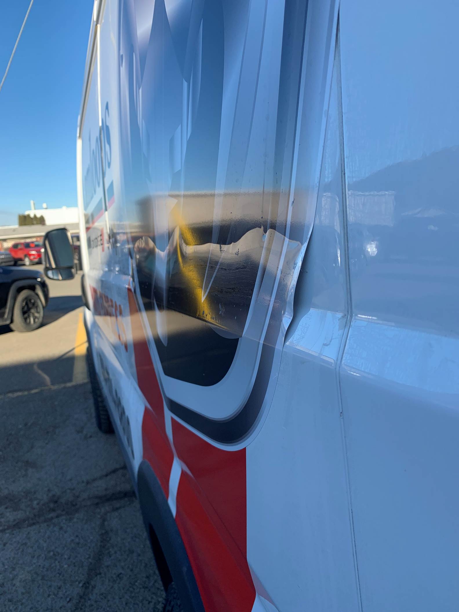

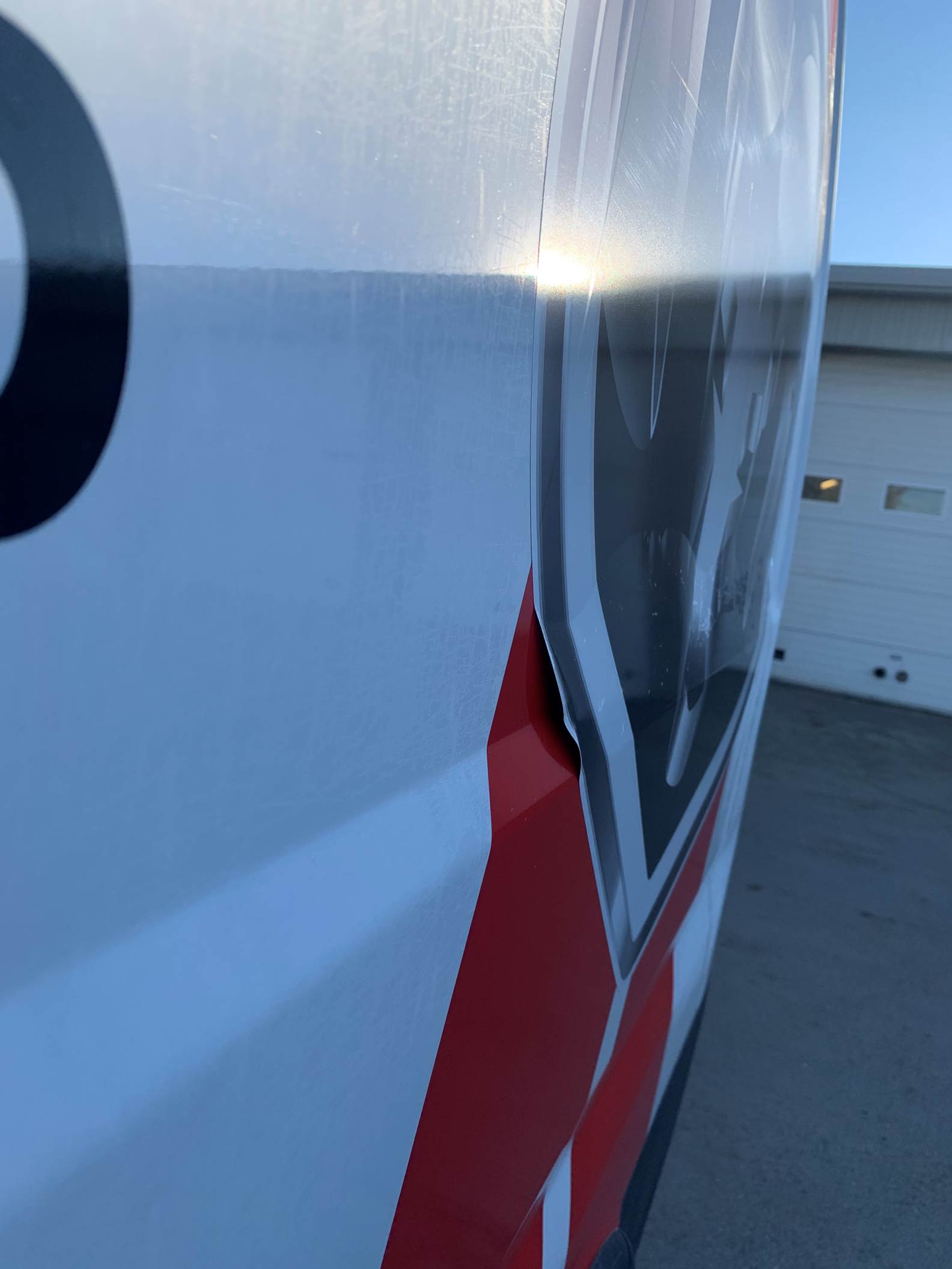

Hey guys,
so we had an install done in January 2021 on mpi2923 and I had fed the graphics into the recessed area, rather than bridging since I was using mpi2923, and the client had just emailed us this photo saying it is now failing. We are located in BC and just after the install date, our temperatures went from +7 - +5 degrees Celcius to almost -20 degrees Celcius overnight. could this have caused this type of issue? I am stumped at how this could have happened with zero stretch in the film. we are now replacing this decal with mpi1105 but that seems to be overkill for this job but we do not want to risk it failing for a 2nd time. Has anyone else had issues with crazy cold snaps causing issues?

Avery 2923 is a calendared vinyl, is it not? So that wouldn't help.
We've had failures here before with even proper IJ180, because of a few things. The best practice is to make sure you're post heating well, and it doesn't hurt to use some adhesive promoter in any recessed areas. You should be able to apply this with either "tuck and roll" (which you seemed to have done) or the tenting method, as long as it's done right it shouldn't fail. Cold snap might have just made it happen faster.
Calendared vinyl though... not sure if that's the right choice. We would have done MPI 1105 EZ RS and good post-heating.
I agree that a cast film would have no issues but the red cut vinyl(which is also calendared) I laid down first in the same fashion is holding strong. I am wondering if I did not post-heat long enough, or if there were contaminates on the red vinyl which did not give the mpi 2923 a proper bond.

I really don't consider that a recessed area. Just a slight crease. It did it all along the entire area, so I'd say it was the the wrong choice of vinyl, not post heating it or both. Also, we usually don't go over the seams as you did. They're gonna lift next. It really does look like you tented it across that area and just pushed it back in. Temperatures..... ?? It could, but not that quickly, unless something was done wrong. A good application should not lift.

It's possible that you stretched it without realizing it. It's easy to do even when it seems that you walked it down into that area. Then with no heat, it popped back up.
Something just triggered in my head. Do you do this in a somewhat controlled area ?? Or is it very cold or are you outside ??

Typically in colder climates leaving the vehicle inside overnight is the best practice. In my mind, all vehicle graphics should be cast/cast combos. Post heating helps the adhesive build maximum bond but calendared vinyl over time will break that bond. Typically the adhesive will separate from the vinyl. The cold just sped up the inherent problems with calendared vinyl.

Calandered vinyl is meant for flat surfaces. Purely flat surfaces... And while that's not too big of a curve... It doesn't surprise me that it lifted.
I don't think post heating it would have helped in this case... I'm used to 3m vinyl, so I could be wrong... But I believe only wrap and cast vinyl has a memory that breaks at a certain temp... Not the cheap Calandered stuff. So by heating you may have got the glue flowing... But the vinyl still wants to go back into its original straight shape.
Also... Metal has more.adhesion than overlam. Even if the red underneath stuck.. The bond between the printed and the red vinyl is way lower. All it takes is that little overlap to lift and then air and water will make the rest lift and tent.
My advice.... Rip it all off and use a cast. Even if you fix it... In a few months once summer hits you'll likely experience the same thing happening and have to fix it again. I've seen a dozen car wrap shops close down in gvrd area because of shotty installs or using crap vinyl trying to save a few bucks. It's not worth it..
