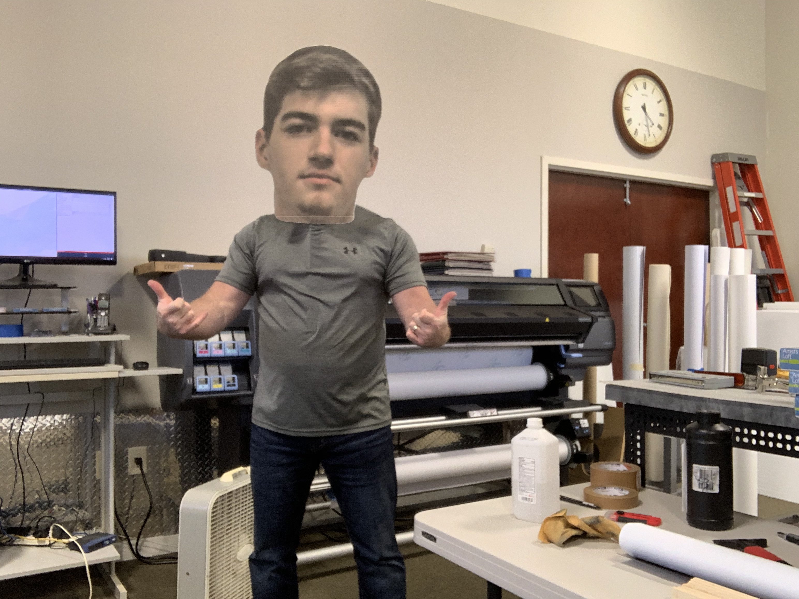

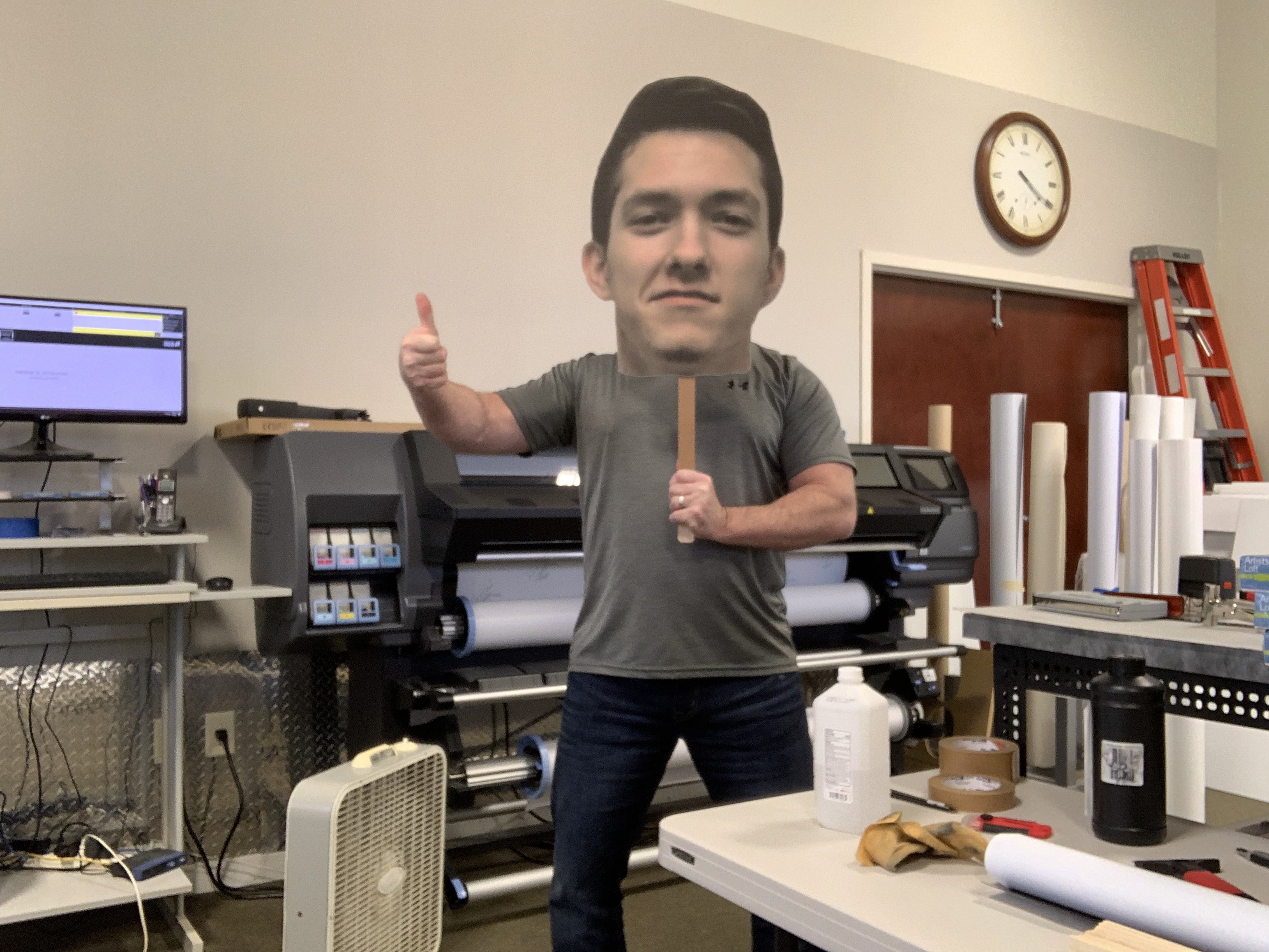

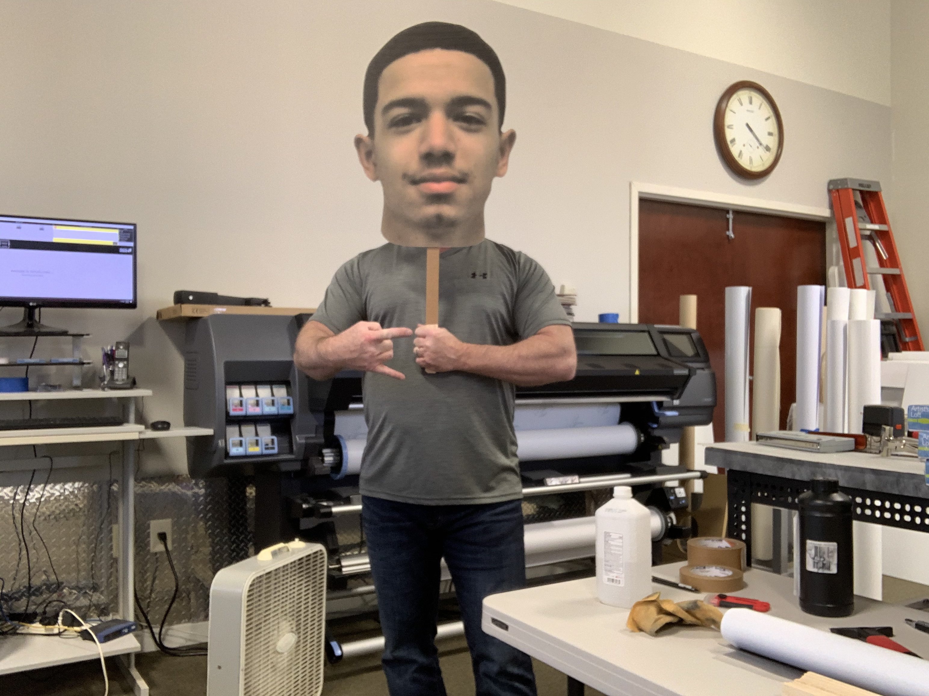

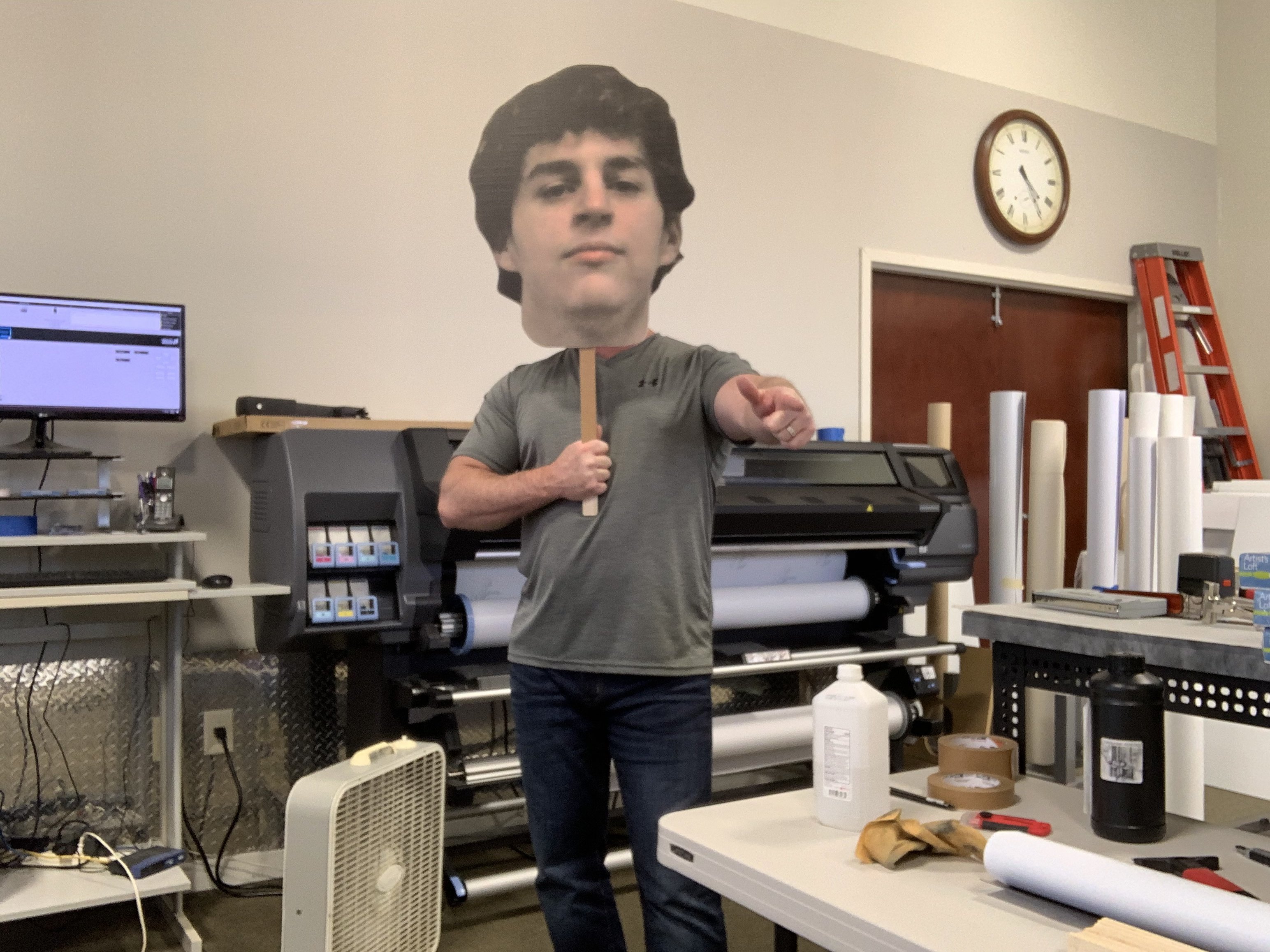

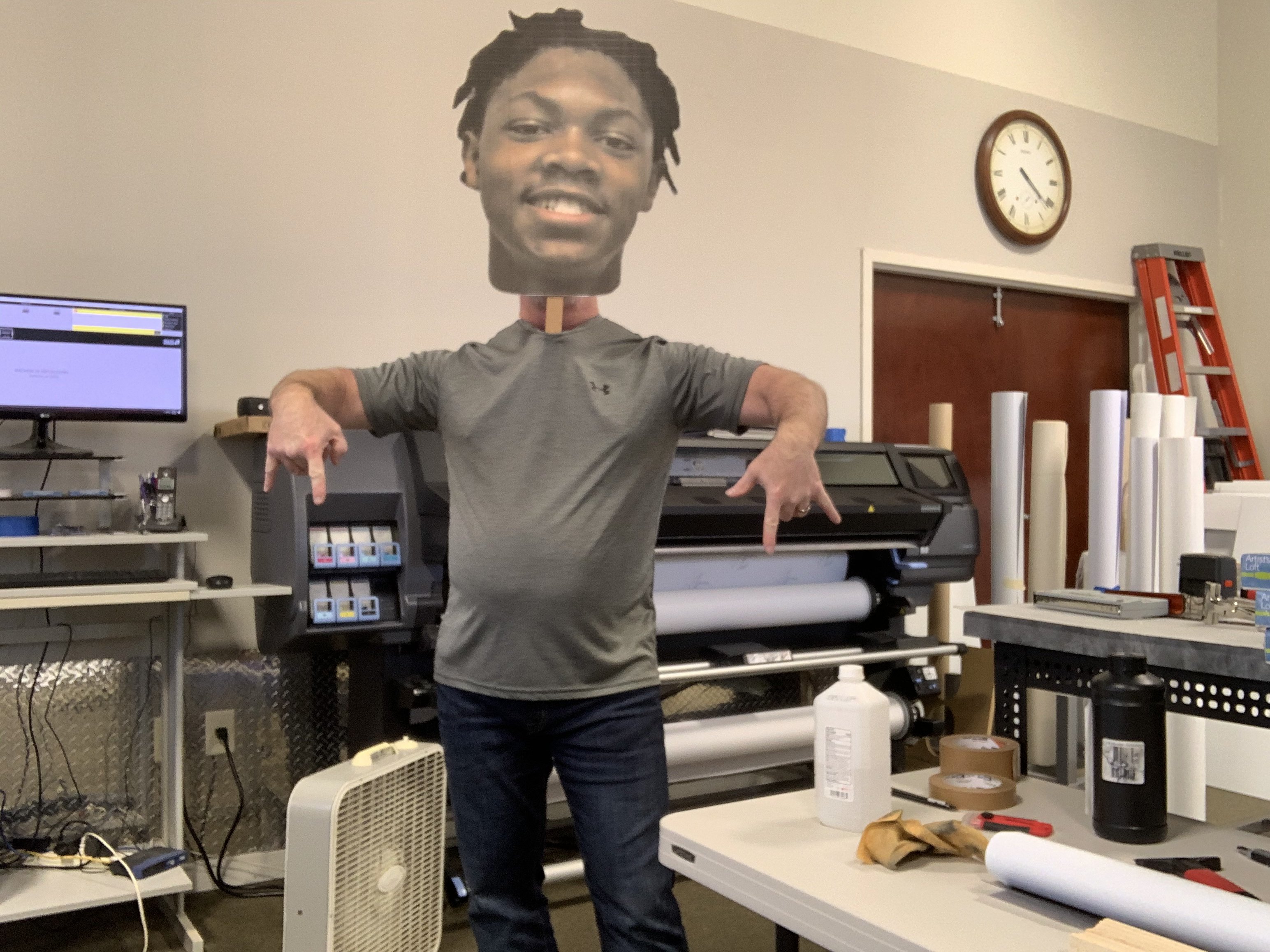

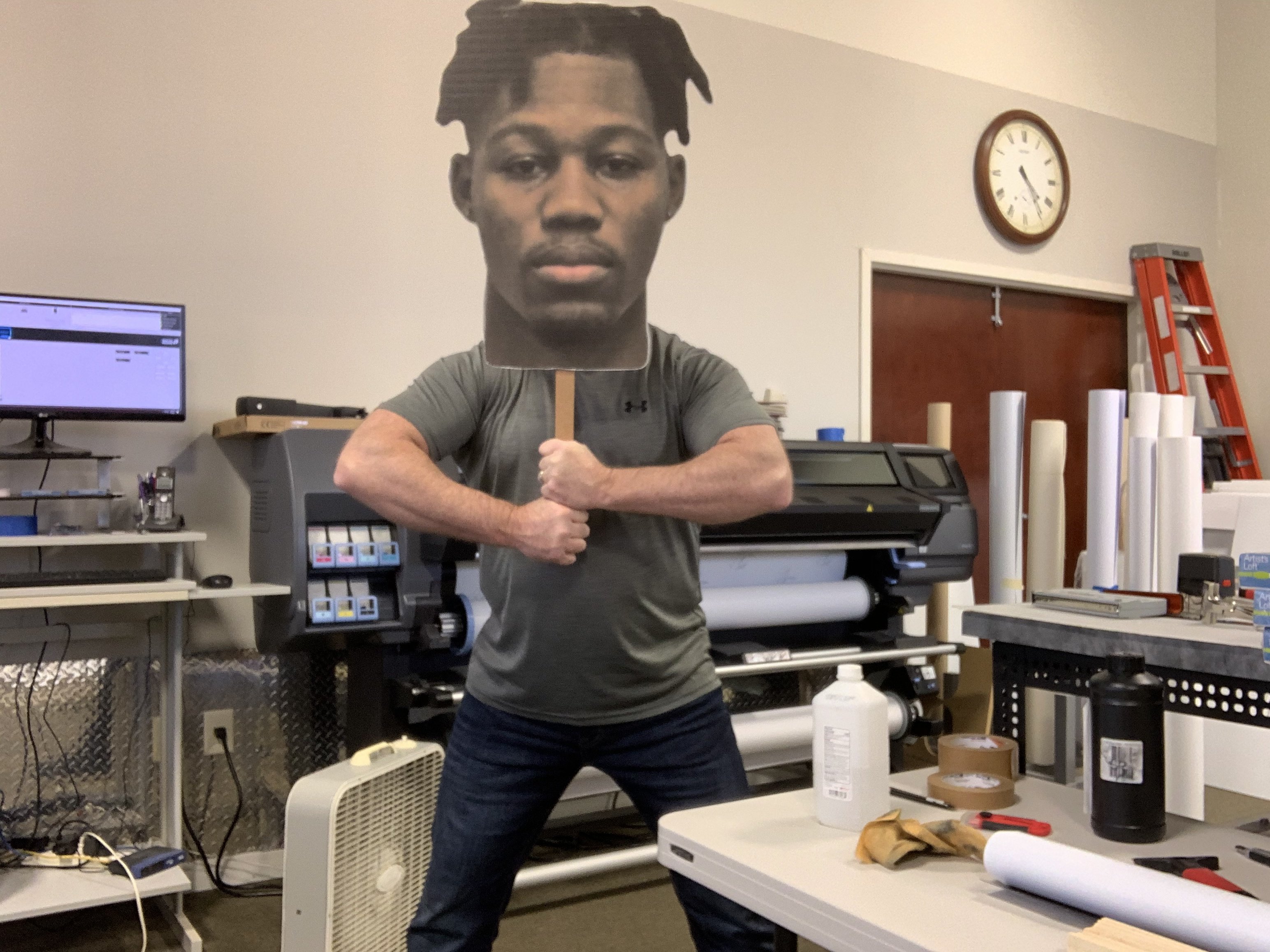

We do a ton of fatheads. Coro for outdoor, foam board for indoor. 5 gallon paint stir sticks are free at a Sherwin Willams paint store. 3m double sided tape to secure to back of head. $21 retail.
