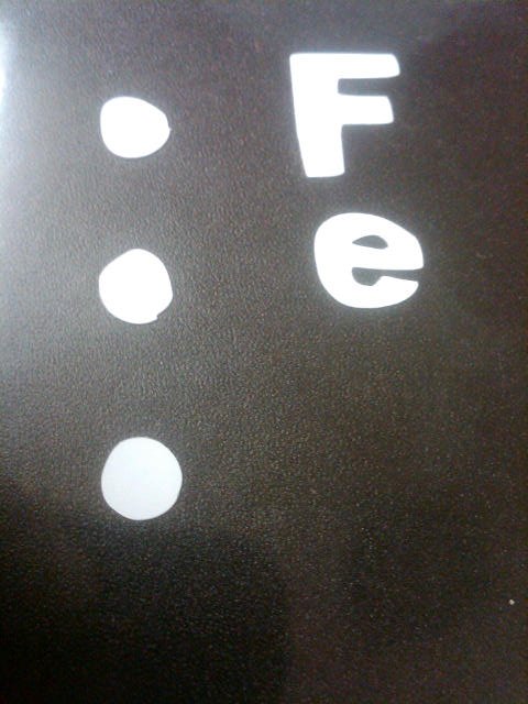

brdss
ok, here is a pic. The bottom dot is the first one cut, the other two followed. Also shown is some of the letters. Had to take the pic at an angle due to the glare. These are SUPPOSED to be round dots! lol

brdss
Force 25 (tried adjust that a little down from the last cut job, as I thought it was cutting a little too deep into the backing paper)
speed 25
quality 1
offset 0
wildside
take the blade out of the holder
spray holder thoroughly with canned compressed air
place a drop of 3 in 1 oil in the holder
reassemble and go
works for us every time, and if still not quite right, change your blade

brdss
Took it all apart, used compressed air through it and oiled it all up!
Partial success! It definitely helped a lot. I had oiled it a few weeks ago, as per a thread here on maintenance, but I guess it was not enough. While the cutting is not 100% true, at least it does not look hand cut! It will do until I can order some blades.
