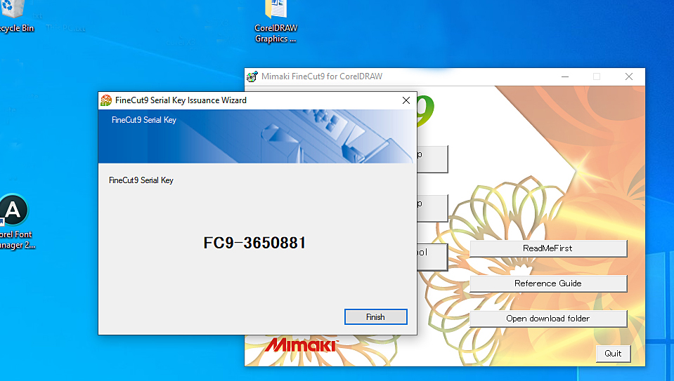

The PC will  issue a FC9 serial key, then it will need the cd to authenticate the  serial key.
Download  the FC9 installer - perhaps that's why I used 9.13 to begin with, not 9.3
Double click the installer- it'll install on the desktop & a menu is displayed
Start the FC9 serial key issuance tool  (click the button)
When the '
windows feature'
windows is displayed, the serial key issuance tool does NOT start.  NOT.
Click to download & install this feature (if applicable).
INstall  net framework 3.5   (my notes say this includes 2.5 & 3.0
Restart the serial key issuance tool after installing those dot net files.

Here's a screen shot I saved during the successful installation - however, we do have an original FC cd - albeit a broken one so i cannot offer anyone an ISO. The cracked centre part means cd readers complain.
